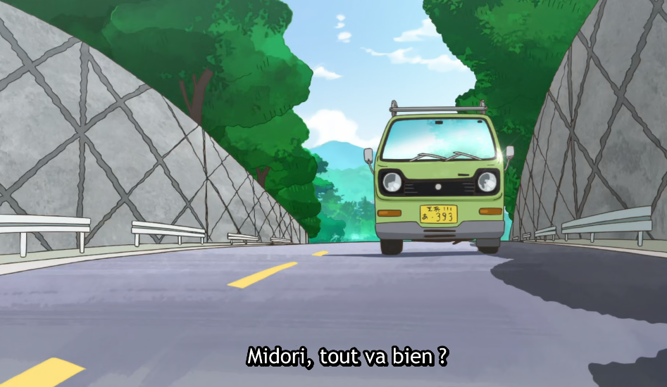

The only ones that should be transcoded during the logs areI checked your logs where you say you played with no transcoding but it is still transcoding using the VLC engine. Did you still play from within the #--TRANSCODE--# folder?
1. The chunk from 2024-01-02-10-15 -- This is to show this specific transcoder does play multiple subtitles at once/defaults to the 'lowest' one on the list. "Odd Taxi" and "Eizoken ni wa te wo dasu na" both played both sets of subs when transcoded. (When not transcoded, both play fine with only one sub track. The solution here is obviously 'don't transcode' but I thought I'd try to capture it happening as a point of interest.)
On Eizoken ni wa te wo dasu na, it shows the first sub in English for about a split second (too fast to easily capture) and then switches to French (track 2) which it continues to show throughout.
On Odd Taxi, it will first show the music note which is exclusively on the Japanese sub track (a closed caption track, which has a music note to denote to viewers a song is playing), and then the English subtitles for the song itself kick in (which is ONLY translated on the English track). But when the episode proper starts, it all goes to Russian (the last sub track by track number on the video). So I suspect it's doing what you'd said and playing the last subtitle stream, and I'm only seeing the other types (Japanese, English) when they don't have a Russian alternative at that timestamp. (And all the other language tracks would be empty during the opening, thus not showing).
2. Part from 2024-01-02-10-11 -- Attempting to play "Kids on the Slope" (Kids.on.the.Slope.S01E01.mkv) which has internal .ass subs with no language tag, which do not automatically play *unless* transcoded. They do automatically play if played through any encoder from the #--TRANSCODE--# folder. The solution here seems to be either 'transcode through something besides VLC' or 'go add a language or forced tag' since VLC transcoding will freeze about 20 minutes in, but still odd. I favored VLC because it's the only one I could get to play My Home Hero with video.
This leads us to...
2024-01-02-09-43 shows playing My Home Hero without transcoding, which has the blank video. I am positive I'm not playing from the Transcode folder here, and mkvs are not set to transcode by default or the like on this run. The computer the files/UMS are running off of may be a factor? It has 16GB Ram and an i7 processor which I think are decent, but it's not got its own video card or the like. This runs okay on VLC (kinda choppy picture) if forced to transcode but will always freeze around the 20 minute mark.
The computer running UMS and transcoding the videos is attached through ethernet, but the devices it's streaming to (VLC on a Firestick) are connected via wifi, which I had thought was fine enough since the Firestick plays shows without issue most of the time, and plays untranscoded videos from UMS without too much issue (besides the My Home Hero video issue). If it's a hardware problem, nothing to be done for it, but it'd be nice to narrow it down to that.
- FrecnhSubs.PNG (803.52 KiB) Viewed 10395 times
