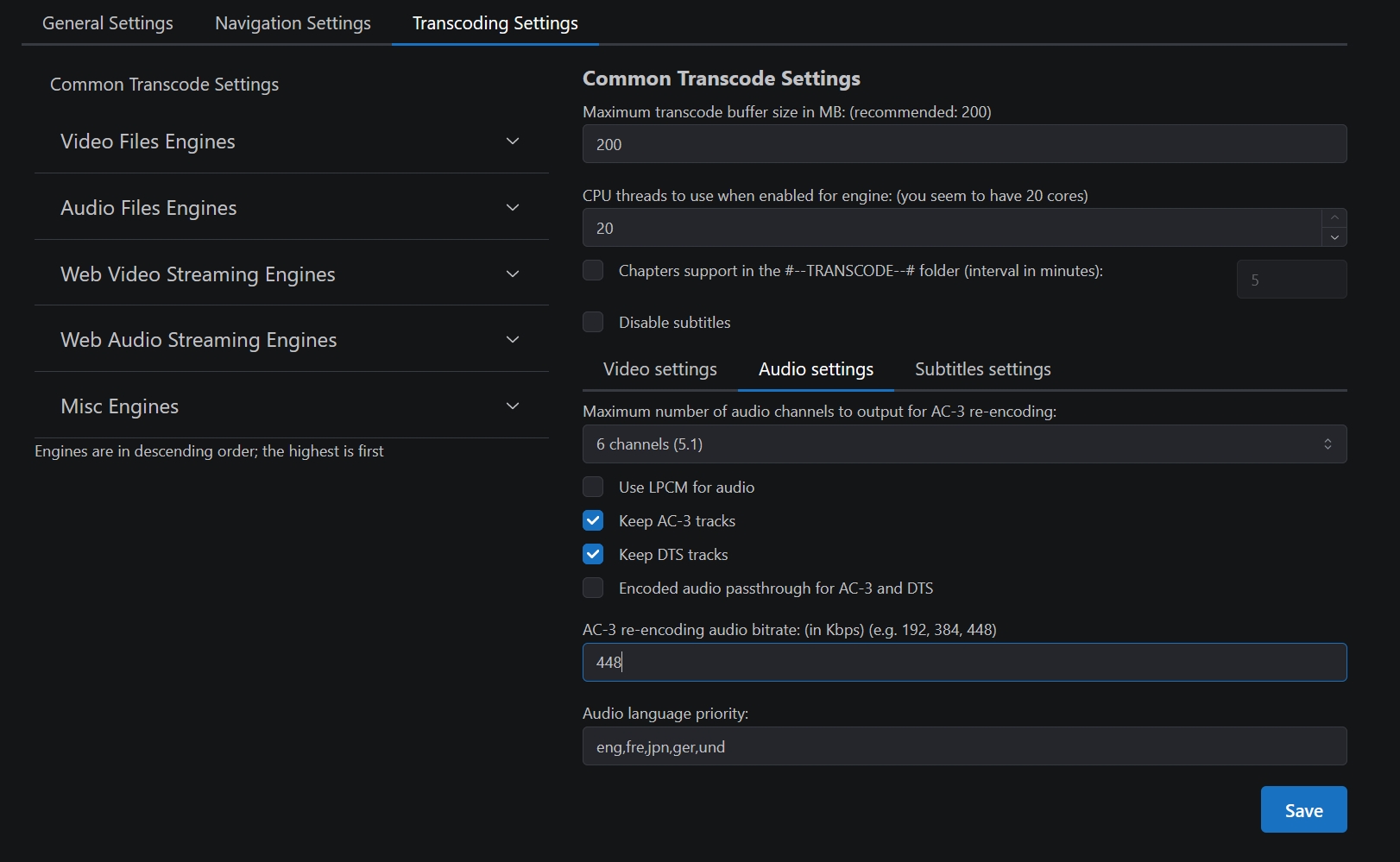

Hello mik_s,
See attached dbg and screen clip:
I just tried a 1080P HD video that has both AC3 and DTS audio tracks. It has Forced English Subtitles.
1. It defaults to AC3.
2. I do not know how to select DTS. Tried checking "Keep DTS" and "Encoded Audio PassThrough".
a. From your last reply I believe I was to select the Transcode Folder.
b. I saw numerous options (most covered with a UK flag).
Did not know which to select. Would hope it would only show fewer. I know you suggested to tyr Transcode folder for DTS.
c. If you could provide another Conf file for me to try w/o my losing what works to this point, it would be appreciated.
d. Is there a way to select the preferred Audio AC3 or DTS when those tracks are included in the file?
e. I can change Audio tracks on PowerDVD 22 Ultimate.
FYI: Audio is so much better using UMS because my A/V receiver detects AC3 when streamed via UMS but not via PowerDVD.
3. Subtitles do not show for this file?
a. I see them when viewing them on PC using VLC. I do see them on the other videos using your mod'd CONF.

- Just checked - Keep DTS tracks. Tried checking Encoded Audio Pass-Through.jpg (268.45 KiB) Viewed 19750 times

Re: [Solved] cant play 2160p 4k video
When the video is transcoded it will use the codec for audio in the TranscodeVideo option which is MPEGTS-H264-AC3 for this conf.
The other one that can be used is AAC but that is not DLNA-compliant.
I know little about DTS but from what I understand if there is a DTS track it will be added as a second selectable audio track if that option is enabled.
Then it is down to the device to use it if it is supported. If DTS is not supported then the AC3 one should be chosen.
If there is only a DTS track and no other audio then the file may not play or play with no audio.
From what I found out from here that TV does not support DTS. Your model group is "20TV_BASIC1 (UHD/FHD)"
As the videos playing in the logs are being streamed then it is down to the TV to handle the subs, see if you can turn them on there.
You should avoid transcoding whenever possible as it will lower the quality of your 4K video and the subtitles will need to be burned in to the video so it does not give you the chance to change them after you start playing it. It will probably prevent you from seeking through the video too.
For "Shogun 2024 S01E07 2160p" I don't think it has any subtitles as it does not mention it in the logs. For "Shogun 2024 S01E07 1080p.mkv" it does pick up the internal SUBRIP subtitles. There is no mediainfo displayed as it has already been stored in the database so I can't be sure exactly if they have subs or what format it is in.
I think I know why you do not get any subs for Indy. It uses the PGS subtitle format which is not supported by that TV as it is image based.
If you download an external sub file and have it in the same folder with the same name (with the language code added) then the TV should pick this up to use instead.

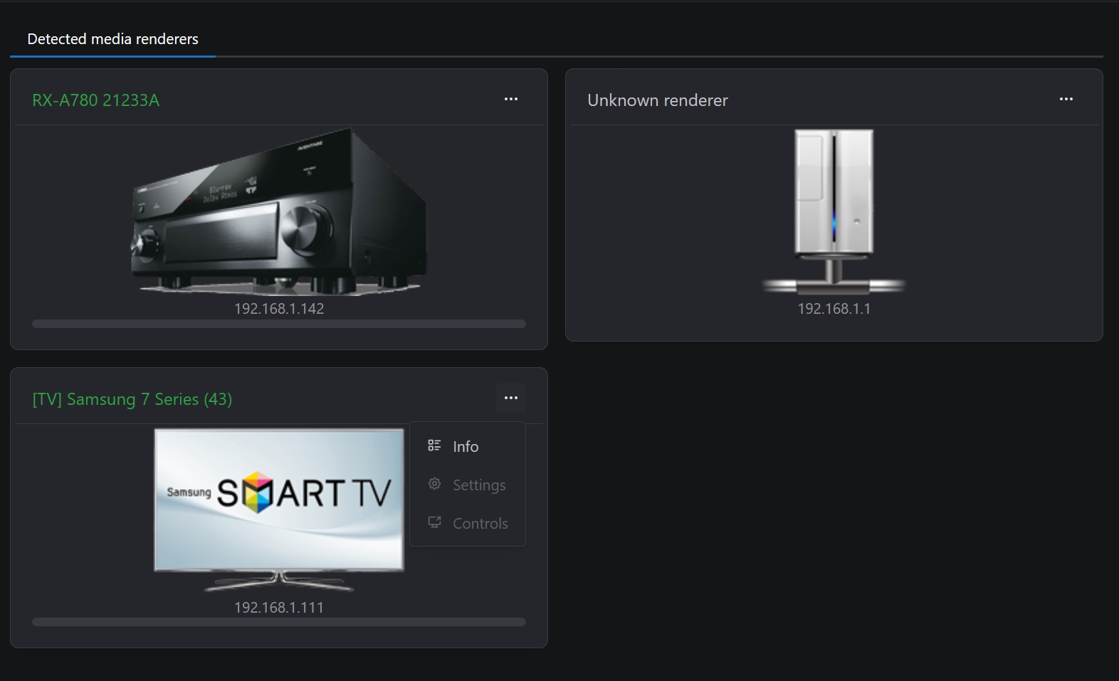

Hi mik_s
1. Yes, the Samsung and Yamaha have eARC and they are connected and I've used it - TV passing audio to Yamaha. No, I've never seen Yamaha display DTS when coming from TV. Absolutely see DTS displayed on Yamaha from DVD and BD's that include it.
2. I'll d/l the second CONF file you created but leave the first mod'd conf file in place. - Tnx!
3. I've attached a screen clip that shows both renderers with Settings and Controls disabled. Just asking what they would do if they were available and why they are not?
I need to tell you, the the video quality and sound is awesome using UMS. I consider UMS the finest s/w media server.

- Detected Media Renderers -Why are Settings and Controls disabled. Same for Yamaha RX-A780.jpg (175.67 KiB) Viewed 19709 times
Check your sound settings on your TV as something must be stopping the Yamaha seeing the DTS track from the TV when UMS is streaming the video.
My old F series Samsung TV does not have eARC but it does have a digital audio out setting that I can select DTS. Yours might have something similar for pass-though.
I'm not sure about the settings option as it does not show as selectable for me either. It may be a place-holder to add settings for individual renderers in the future.
The Controls will be enabled if UMS receives the information to control that device it over the network.
It shows up for my TV but I don't use it to to play things on as I use my PS4 for that.
I found it was a bit hit or miss when I tried it a while ago but this may be because my TV is old and not very responsive. I at least know that it will change the volume as I just tested that.
I am also using a beta version of V14 so it might not be enabled yet in the web interface on main, but should be accessible from the old GUI.
