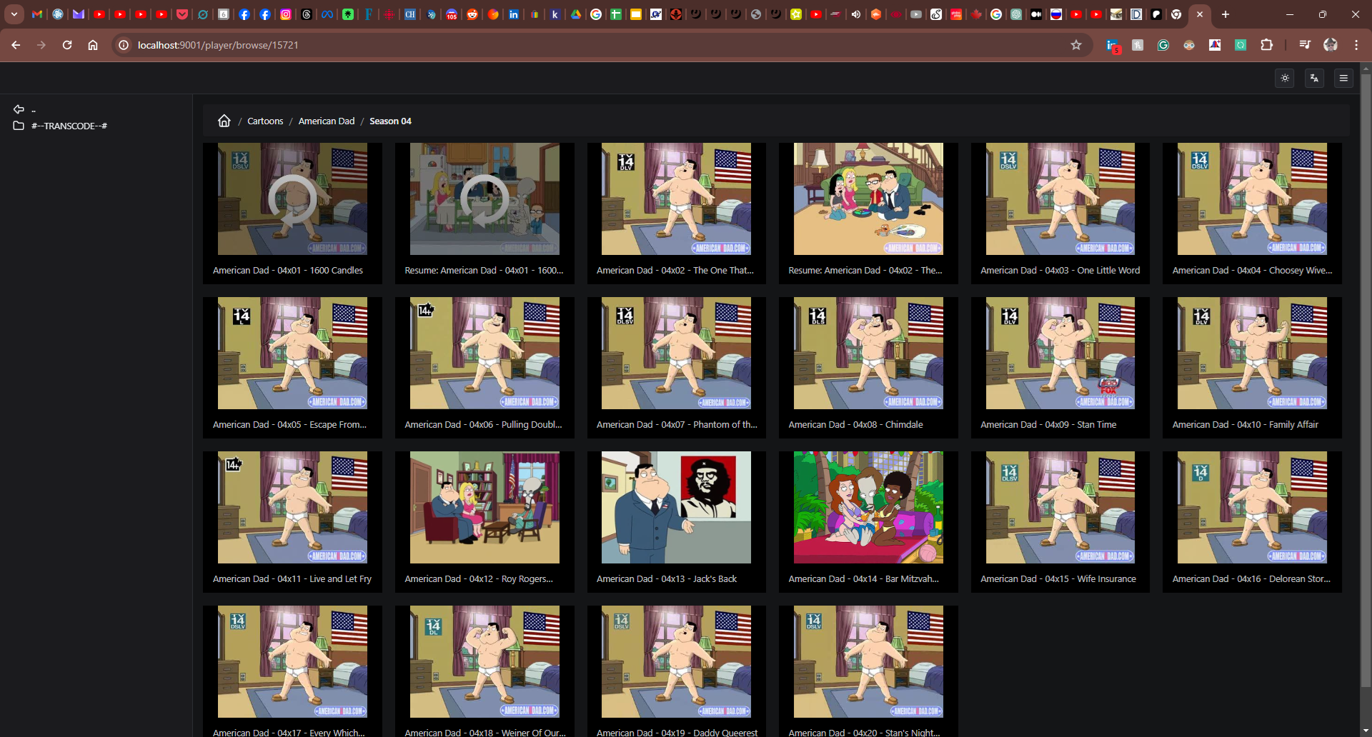

I uninstalled both UMS and Java, removed the shortcut from my startup folder, restarted the computer, and reinstalled UMS with the basic conf and just one share. I realized that now the old settings are very different, and have fewer options. I didn't select the option to start with Windows, but UMS is doing it anyway.
And now it doesn't mark the files as played anymore. 😣 So before I uninstalled it, it marked the files as played but the mark disappeared after the restart; now there is no marking at all. At least it seems that the ghost instance is not there anymore because every time I restart the server the web interface opens whereas before this only happened when I restarted the computer.
Any ideas?

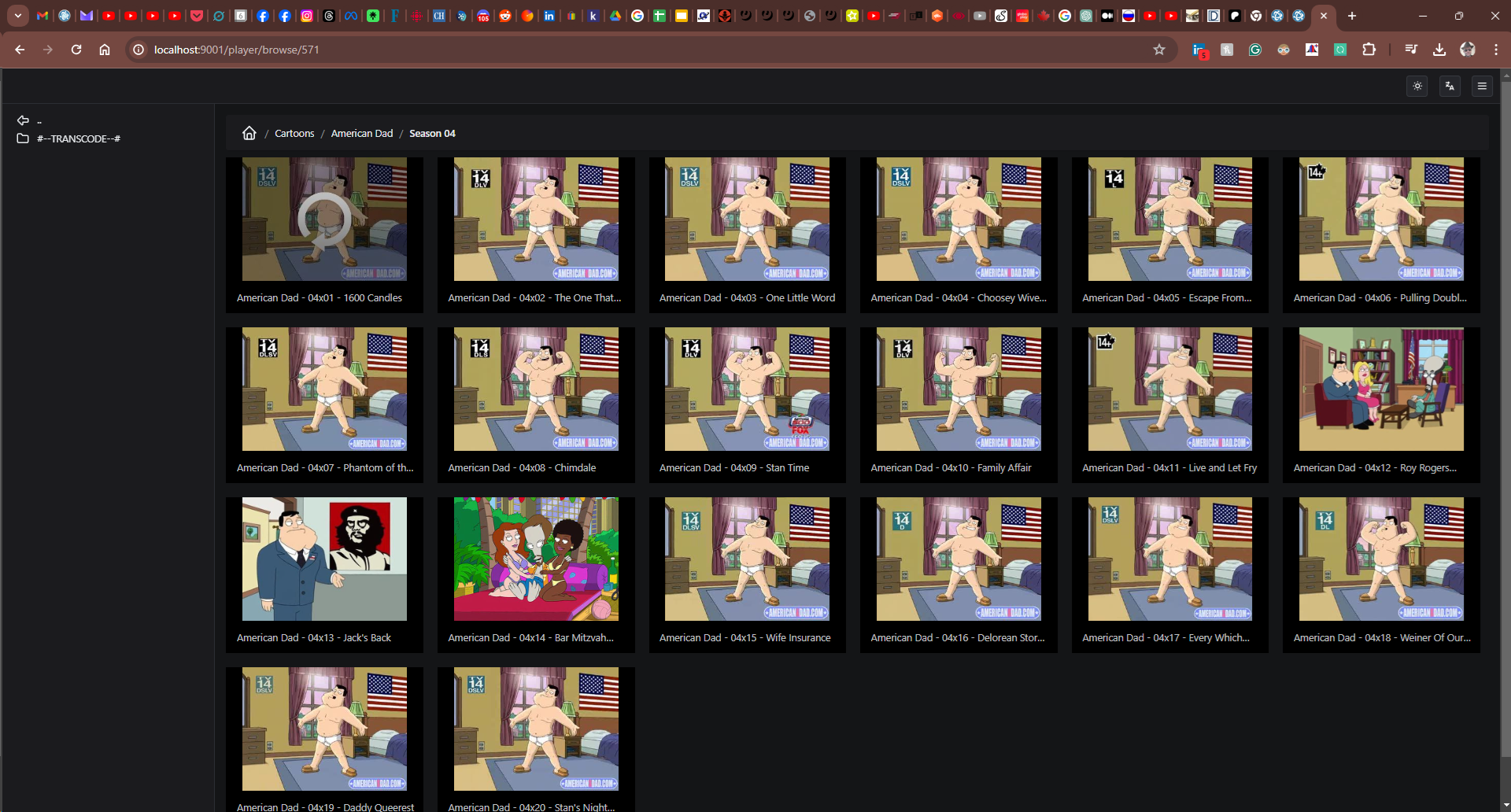

Now I played several videos back-to-back, on my media player - it shows as "on video" on the logs and it's the same one I used to take the screenshots on the second reply.
Before I created the first post and made all the changes I mentioned here, the files were marked as played after half the video was played, and it even happened if I fast-forwarded. It never failed to show the played mark, but it could be delayed a few seconds - on PS3 it displayed the "thinking clock" - I don't how you call it but it's that small clock that shows something is being updated. And now all players show that things were played.
However, after I restarted the application, one of the videos changed its status:
Bottom line, things are better, but still there's something going on. I'm sorry but I don't have a log for the last issue. I will try and replicate it to see if I can get a log. I couldn't make the file debug.log.zip to be less than 5MB, so I'm attaching it to my next reply.
