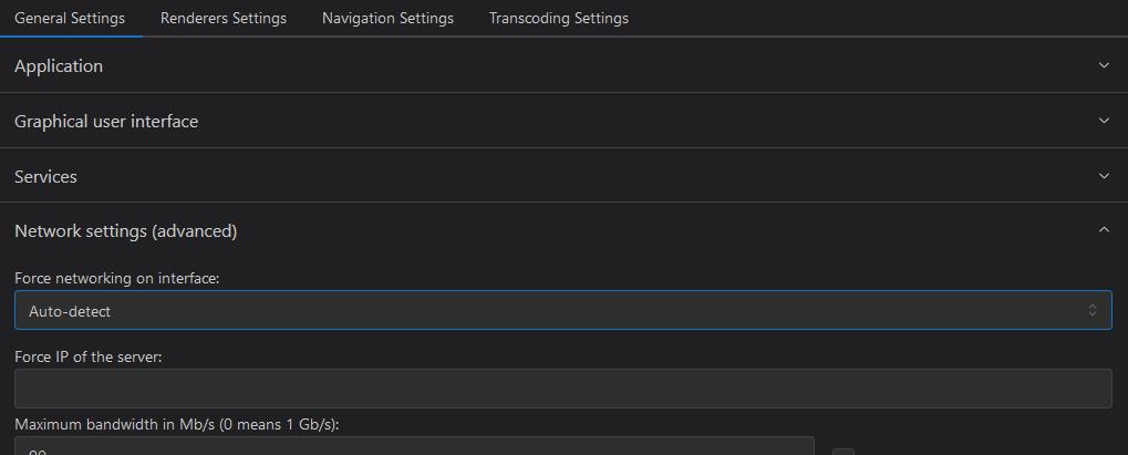

For some reason UMS is still picking the VPN network interface over the real one when it shouldn't
It is using
instead of
Manually forcing the network interface to "Realtek PCIe GbE Family Controller" should fix it.
You Might be unable to access the web settings if it is broadcasting on the VPN network so you may have to do it on the old Java GUI
(right click the tray icon and chose settings old)
Did this just suddenly happen after it was working normally for a while? Was anything updated on your computer around the time this broke?
If so then I can open an issue on Github to improve auto-detect.
