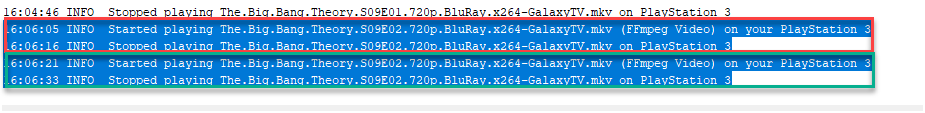

3 - It seems that there is something wrong loading FFMpeg: the first block (red) was pixelating. Then, I went to the #transcode folder and loaded the same video again using FFmpeg (green) and it showed correctly
4 - I changed the first encoder to MEncoder and the issue was fixed.
5 - I updated to V 14.3.0 and it was still working fine;
6 - I restored my previous configuration and changed the first encoder to MEncoder and it fixed the issue.
I know it's working now. but this is not a good fix because I have problems with MEncoder dealing with 5.1 audio channels, both in Dolby and DTS; that's why my first option was FFMpeg. So, if you guys could help me figure out why suddenly FFMpeg only works under #transcode I'd appreciate it.

Also had it! :!: Strangely happens, when playing the file as usual, as for an ex., mostly the MKV (AVC), but OK with the "Transcode" folder.

I have the same problem, but have had it for some time (many versions ago, but I'm not sure which, sorry!). I upgraded to 14.3.0 recently thinking the issue might have been solved. Sadly, no. I have reproduced the problem and zipped up the trace logs, which I will attach to this post. Important to note is that the test video also works properly for me when I play it using FFmpeg via the Transcode folder. When played normally, no dice, even though FFmpeg is the default. Pixelation city. Video throughput on the PS3, Transcode versus "normal", is a 10 to 1 ratio. I have many videos that do this, not just the one I chose as a test for the purposes of getting support.

Re: Too much pixelation after update to 14.3.0
I'll have a good look into this again later, but I did see a difference in the transcoding command when that video was played.
I'll have to do a bit of experimentation to see if I can reproduce this on my PS4.
Which one was playing normally and which was from the transcode folder?
There was a similar bug I discovered recently where FFmpeg would give an error so this may be related to that.
Post by Putzo1234 »
The first attempt was normal and the second was from Transcode.
Thanks!
Thanks for the logs, I can see the problem and am working on a fix now
