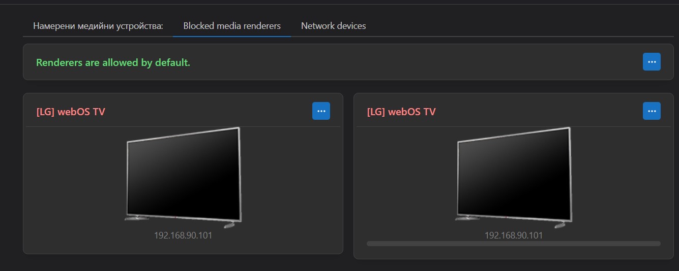

I blocked LG. I don't know if that's good fot test? it show twice!

The reason for the duplicate of the LG is because they have a second screen function that UMS thinks is a second renderer.

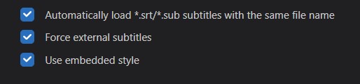

Waw the Sony sees external subtitles. But not the built in .mkv.
And in "No transcoding" mode, it reads only the built-in subtitles, but not the external ones.
Hah.

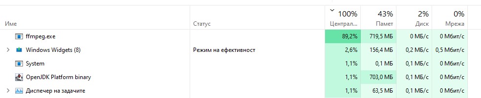

Another thing that puzzled me is why the processor is loaded at 100% when I move through the folders?
Hah.

The high CPU usage after a clean install will be UMS scanning your files and building the database. This should not last too long though.

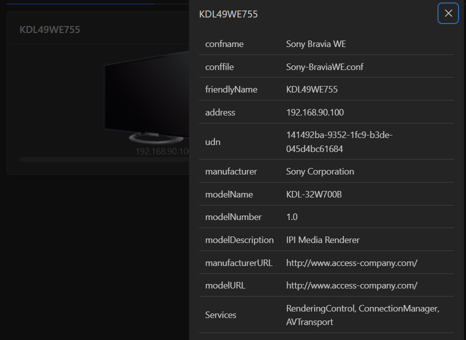

I have been looking into this a bit more and the information coming from the TV about what model it is is strange.
KDL-32W700B is the W7B series from 2014 and does not support h265
KDL49WE755 is the WE75 series from 2017 and this does support h265 (and HDR)
This is a comparison between them but I think the page is auto generated and may not last long.
The conf is for the W series but maybe there should be one for the WE series too.
Problem is the way the TV is identifying itself as it says it is both and with different screen sizes (32in v 49in)
I have updated the conf to define the subtitles format SUBRIP and added divx and eac3 formats as these were the things I saw causing transcoding.

New renderer found: "KDL49WE755" with dlna details: {friendlyName=KDL49WE755, address=192.168.90.100, udn=141492ba-9352-1fc9-b3de-045d4bc61684, manufacturer=Sony Corporation, modelName=KDL-32W700B, modelNumber=1.0, modelDescription=IPI Media Renderer, manufacturerURL=http://www.access-company.com/, modelURL=http://www.access-company.com/}
I'm not sure if eac3 is supported but saw it is in the X series so it might be.
Double check to see if "Alita Battle Angel" and "The.Flash.2023" plays correctly with audio as these use eac3.
There will be other changes to what the TV can play but is not something I can do as it requires testing to see what works.
If something is transcoding then try to play with "no transcoding" and if this works this format can be added as supported.
Hopefully with the sub format listed it should be offered to the TV if there are external subs.

About subtitles - things are the same. In fact, don't they cause the transcoding? Automaticaly load and force external options?
