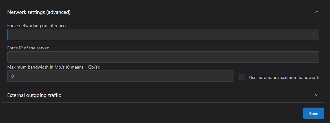

As mentioned above, please bind to the network interface of your host system (has the same IP address as the NAS). Then the NAS will show up. Advanced configuration needs to be selected.freemansteve wrote: ↑Sat Nov 02, 2024 10:52 pm I am therefore asking if anyone has any pointers for systems using Docker Container and UMS for these problems?

I have revisited my attempt to get UMS as a docker image running on my DSM 423+ with DSM 7.3x
Starting from scratch, I re-installed the image and set up the user stuff (like where my mucic files are, and also created some other folders for reasons I'm not yet sure about), and the UMS docker image runs (apparently), but still I have no visibility of it on my LAN.
The network setup is confusing, as "bridging" is mentioned, but if bridging were used (a MAC-level thing), I would not need to set up a subnet (I have used the default 172.0.17.0) so I need to set up routing I guess (IP). Ok, but how do I "bind to the network interface of your host system"? Is this setting up a static route or what? Where do I find the settings?
freemansteve
- Posts: 34
Re: [Tutorial] How to install UMS in Docker
NB, I can access <my_NAS_IP>:<ports> to view the server setup, media folders etc, but I meant that I cannot "see" UMS as a server from the point of view of any of the DLNA renderers on my LAN - it appears to be undiscoverable..... DLNA seems to be set up OK by default....
Have you tried to force UMS to use the right interface? UMS may not choose the right one if several are available.
I don't know much about Docker but I remember you need to bridge the computer's network interface with the container's but that is as much as I know.
Make sure your computer is actually on the same subnet as the other devices on your network too otherwise they will not be able to see UMS.

Thanks, but still no luck.
My choices were "lo" or "eth0..." but neither worked.
The container claims to be on its own 172 subnet, and the NAS on my LAN is on a 192 subnet and if so, routing would be necessary, but the term used in Container Manager is "bridging", but then, you cannot bridge two subnets, which is the whole point of having separate IP networks. If it were "bridging" it would be on one IP network....
I'm wondering if UMS actually works at all under Synology's container manager, or if there is a vital setting I have missed?
