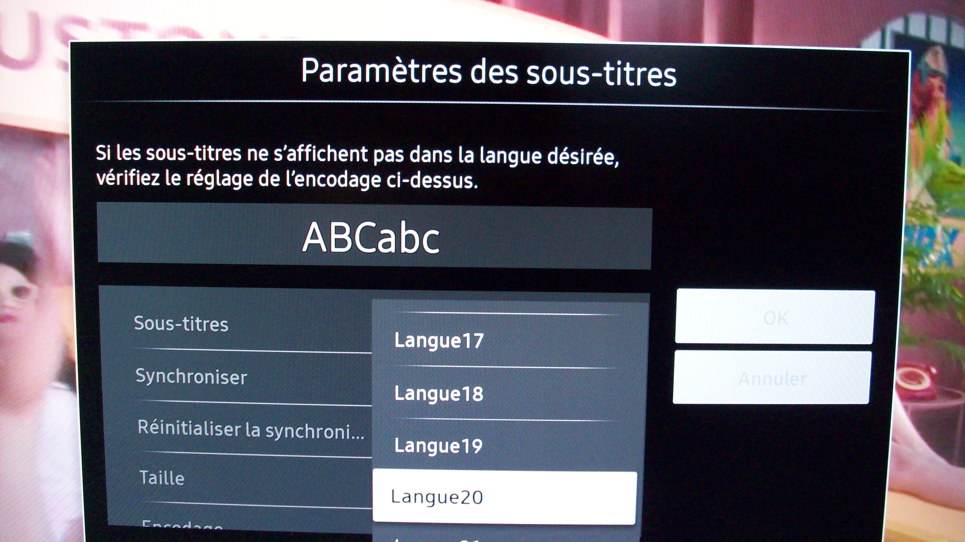

I am trying to play some video with multiple subtitles that are integrated within MKV files. Instantly the Samsung player plays the video but when the subtitle appears on the screen it freezes the screen for a moment, as if the player can't keep up with the pace. I also realized that the country languages ??in the settings are not recognized by their proper name in the Samsung player. My question is whether it is the Samsung player that is the cause or there is an adjustment that I need to make in UMS or simply this is a bug.
Thanks!

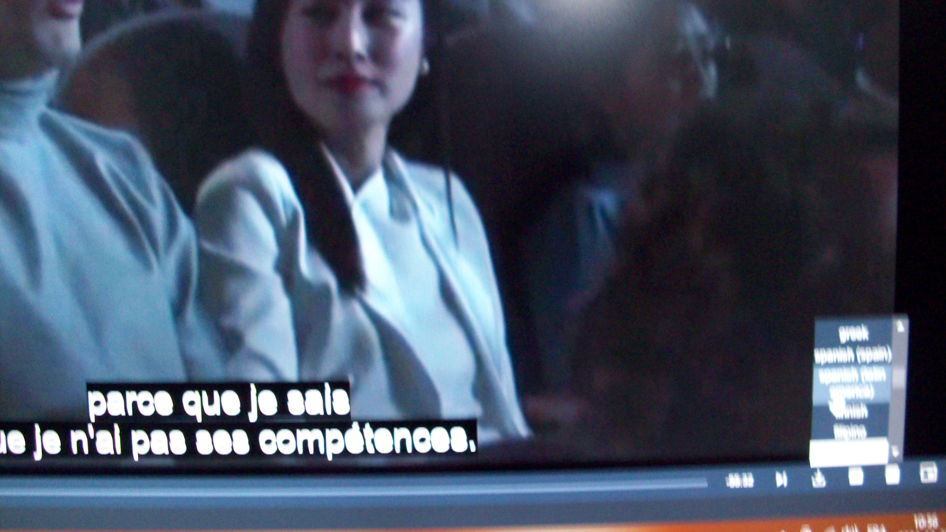

Yes, I did use the transcoder, but with no transcoding I had the same problem. With FFMPEG or MEENCODER it worked with the French subtitle only. As for VLC Video it didn't work at all.
But when I play the video on the UMS Web interface it works very well. With the subs a little bit in the fog and the corner. See image

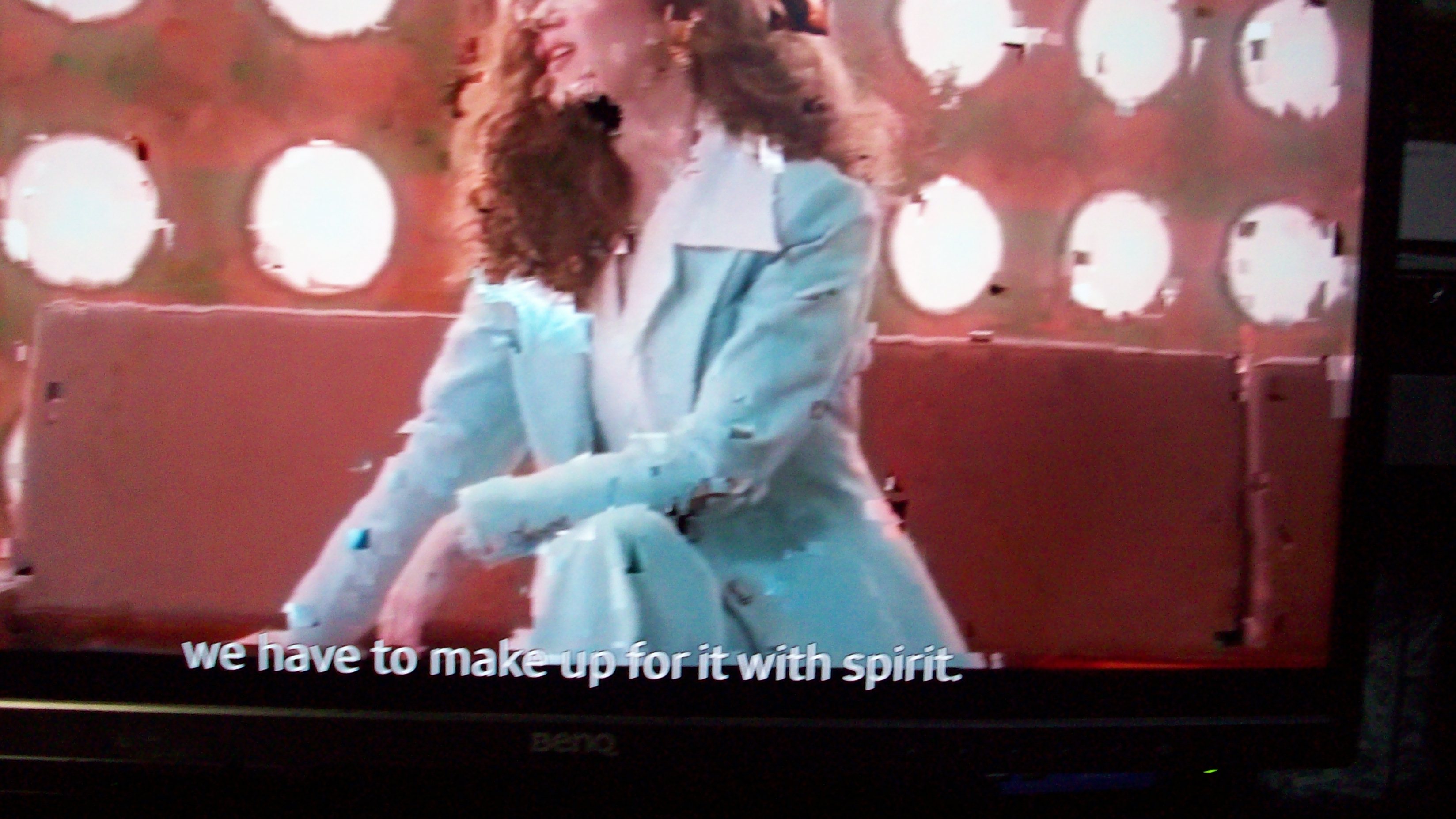

I have the same result on a USB key, as soon as the subtitles appear there is a temporary freeze of the video.There is no change in the languages ??they are always indicated as language 1, language 2 etc..

This confirms there is something wrong with that video, maybe the way it was encoded or something in the subs that is causing your TV to crash.
This is probably why mine won't play it either.
