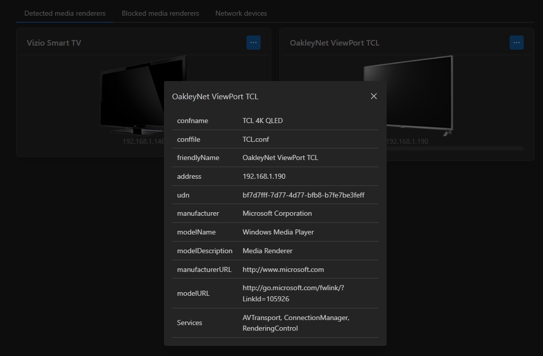

The Transcode "folder" actually shows as a "Settings" gear icon, when I click on it then the movie is already there...
I didn't copy anything into anywhere except the new TCL.conf into the Renderers folder, and Yes the TV shows with that.

OK it is good that UMS is picking up the right conf now for the TV.
You could try a Roku version at the same time as the they have different matching criteria so should not conflict. This will let you test the Roku app as well.

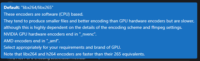

The way HLS works is it splits the video into chunks of about 5 seconds and creates a playlist of these chunks to send to the TV. UMS will log each chunk as a playing event as it has to run FFmpeg on each of them, so it is normal to have many start/stop playing events with this format.
This could also be the cause of the audio glitch you are mentioning as a new chunk starts playing. It looks like transcoding is being done on the CPU. If you have a graphics card that supports video encoding you could enable this and that might solve this glitch. Chose the _nvenc ones if your GPU is from Nvidia or look at the other options if not to find the suitable one.

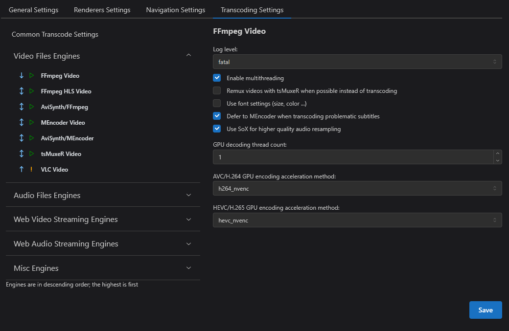

Screenshot 2025-03-04 163538.png (49.13 KiB) Viewed 50873 times
Screenshot 2025-03-04 171257.png (20.3 KiB) Viewed 50873 times
The engine name will either be [FFmpeg] or [FFmpeg HLS Video] as that is what is used to do the transcoding. There are other engines like Mencoder that are useful for certain formats but won't do HLS. If you see an engine name then it shows that the video will be transcoded and not streamed.
As the video is being transcoded the TV will show the format as a .mpg so this is correct, this is the format of each video chunk sent to the renderer.
That warning can be ignored, UMS is just looking for a service that does not exist so the device responds as bad request.
The videos with internal subtitles should be working properly and you should be able to turn on the subtitles on the device or the web player like you confirmed with that test video I asked you to try. Remember that the sub button on the remote may not turn these on and there could be some other control for the player like I found on my Samsung TV.

I also found that TCL is Roku so those confs I made for it are not much use, especially as you are using a separate Roku device anyway. But in the last logs I did see it was being used and the "underground" video was being streamed and appeared to have internal subs so you can use that for testing
I also saw the formats they are supported by Roku and I see why it made sense to only use HLS for everything.

As the transcoding format is HLS then it has to use FFmpeg even if VLC is a higher priority on the engine list.
