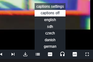

I have checked many of my videos, each/all with EXTERNAL Subtitles, the ONLY place I can see Subtitles consistantly is in VLC and other Desktop Apps, where I can also choose which subtitle file to use on the fly, and when casting from such to the TV, they also shows fine.

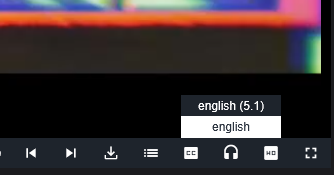

But NOT in the UMS webplayer. In UMS, even just the webplayer does NOT show the controls to allow for choosing a subtitle file, and most of the time it also does NOT show the "headphones" control icon either... EVERY movie is an HDR or UHD with 5.1 Audio at least not sure why they DON'T have any Internal Subtitles.
So, when UMS is reading, buffering, processing then transcoding, somewhere along the line, it is dropping the connection/search for subtitles...

If those controls are not showing it is because the video does not have those data streams to change to.

I can email you a link to access my UMS ... I had it setup that way previously, but put password protection on it recently...
Downscaling of a 4K movie, nor just playing it on a 1080 TV will not bother anything "Subtitle" related - they will play, and look good.
You want me to post Logs of me trying to play movies thru the Roku to the TV ?
Yes, that test5.mkv showed Subtitles thru the Roku to the TV ... but those are INTERNAL...
So, EXTERNAL subtitles are not working in the webplayer either.

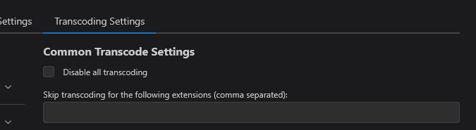

I tried disabling All Transcoding, nothing changed... so I reenabled it.
