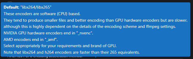

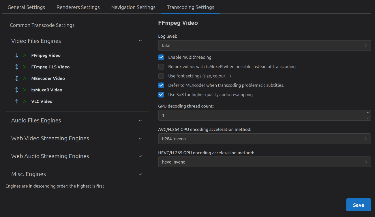

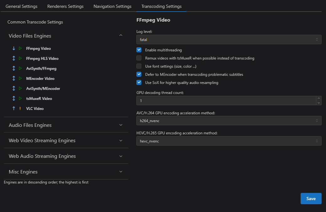

Did you set it the GPU encoding acceleration method?
Screenshot 2025-03-04 163538.png (49.13 KiB) Viewed 59995 times
Screenshot 2025-03-04 171257.png (20.3 KiB) Viewed 59995 times

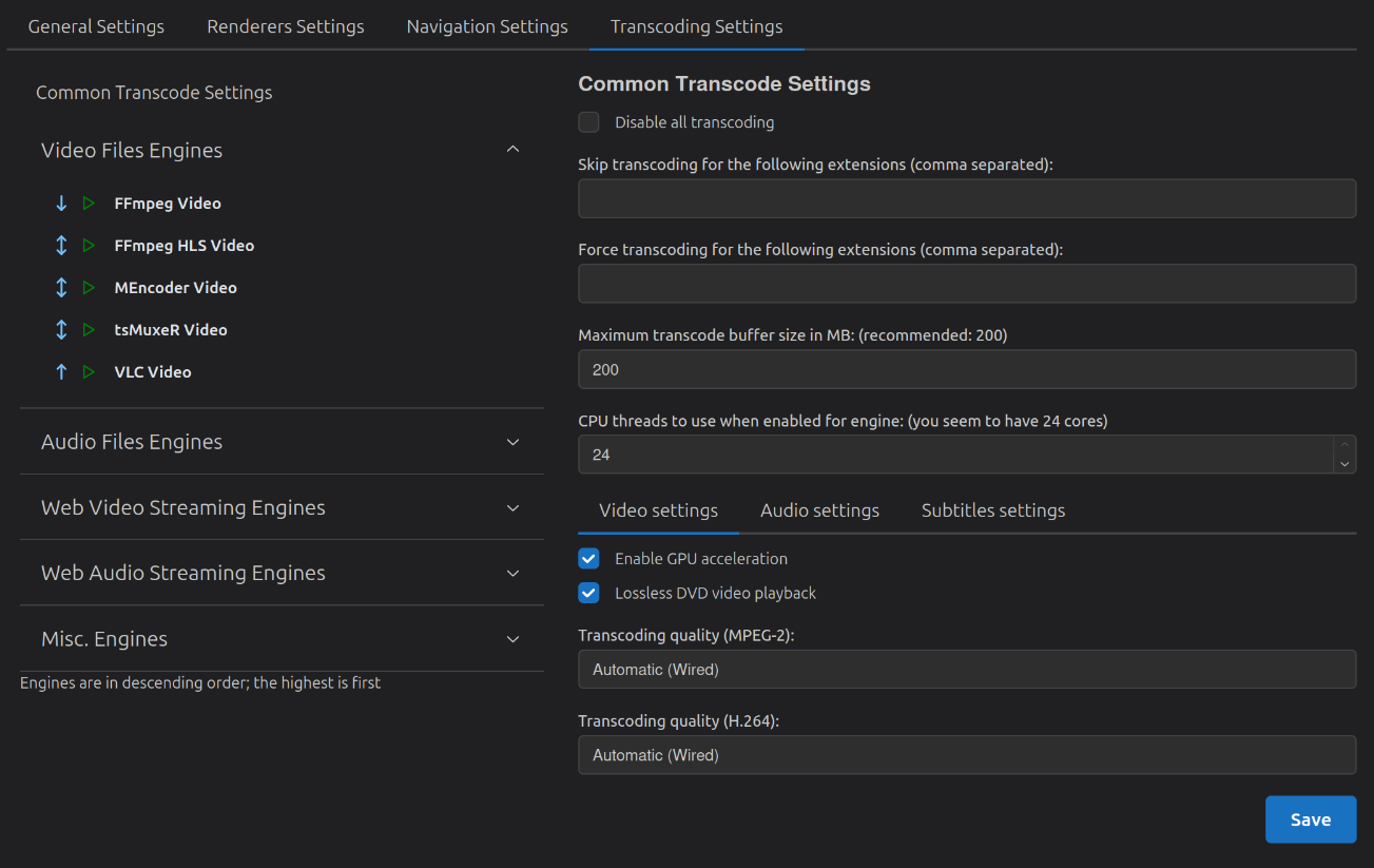

I believe I have set this correctly? Refer to below attachments:
Common settings
Common settings
Screenshot From 2025-03-17 00-12-44.png (162.13 KiB) Viewed 59942 times
ffmpeg settings
ffmpeg settings
Screenshot From 2025-03-17 00-13-47.png (136.86 KiB) Viewed 59942 times

Yes, I forgot to mention - I did try that, but it also didn't work - the below is the result:
ERROR 22:25:46.974 [jupnp-stream-server-106] No Hls configuration to transcode.
ERROR 22:25:52.974 [jupnp-stream-server-106] There is no inputstream to return for bbb_sunflower_2160p_30fps_stereo_abl [FFmpeg HLS Video]
Interestingly, I also tried a slightly older version of ffmpeg I compiled myself with all the nvidia headers included - and it also threw the error 234 (same as the OS version of ffmpeg) - it still makes me wonder if the hardware transcoding is somehow completely broken with this nvidia driver? It's a real headache to downgrade to an older version - but I did find a single commenter online who suggested HW acceleration might be broken driver >535 (I'm running 560 non-open driver). As I only found a single comment on that, I'm not so sure it is true however...
