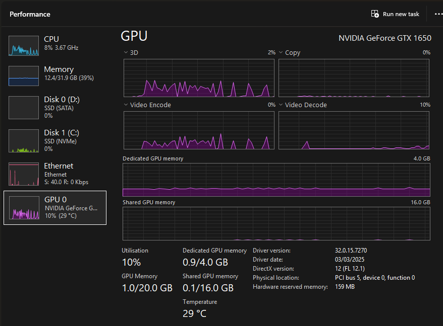

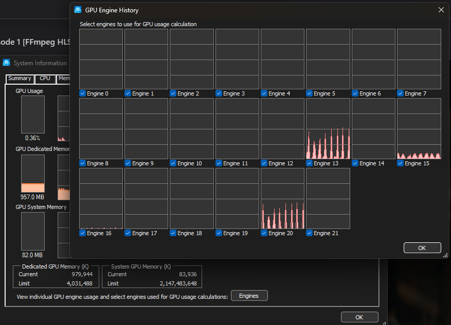

This is what it looks like playing for me with a GTX 1650 on windows according to Task Manager and Process Explorer
Starting "C:\Program Files\Universal Media Server\bin\ffmpeg.exe" -y -loglevel info -t 6.0 -sn -i C:\Users\Mik\Videos\video.mkv -sn -dn -copyts -c:v h264_nvenc -keyint_min 25 -profile:v high -level 41 -pix_fmt yuv420p -c:a aac -ac 6 -ab 320000 -f mpegts -skip_estimate_duration_from_pts 1 -use_wallclock_as_timestamps 1 -movflags frag_keyframe \\.\pipe\ffmpeghlsvideo_67_1742047834493

Screenshot 2025-03-17 184929.png (58.01 KiB) Viewed 32122 times

Screenshot 2025-03-17 184758.png (55.99 KiB) Viewed 32122 times
Also try with setting to use the FFmpeg version installed by UMS as this has the HLS feature enabled along with some others it might need.
This should also have the Nvidia headers included in the build.
