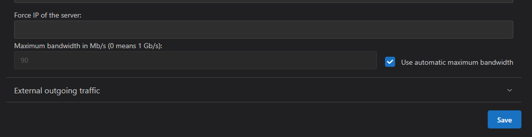

Set this back to the default 90 and turn on "Use automatic maximum bandwidth" so UMS will run a speed test to use the best value for your network to the TV.
Screenshot 2025-04-10 072809.png (11.24 KiB) Viewed 99835 times

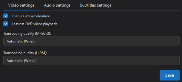

There are also a couple of other options that could be causing it to fail. Set "Transcoding quality (MPEG-2):" and "Transcoding quality (H.264):" to Automatic (Wired)
Screenshot 2025-04-10 071810.png (12.72 KiB) Viewed 99835 times
You will have to change these before turning on use automatic maximum bandwidth as it disables this selector.
I'm not sure if it also ignores the settings here but best to do it anyway.
