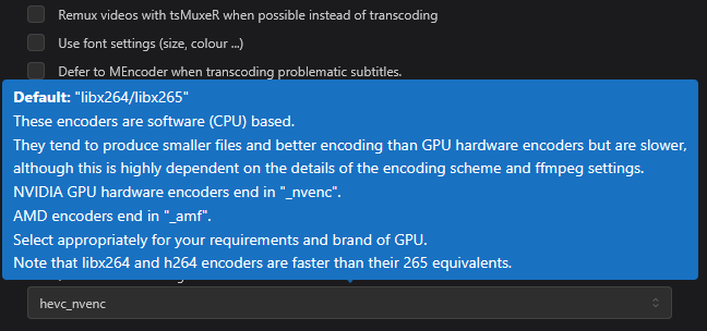

You can offload most of the processing to the GPU if it has a video encoder. Check the settings for FFmpeg transcoding Transcoding has the downside of having problems with seeking on some players as the video stream is destroyed after being sent to the TV so it takes a while to restart transcoding if you seek to another point. Some players will even disable seeking altogether.

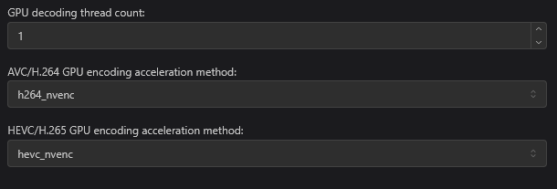

Thanks for the feedback, I will give those GPU transcoding a try!
