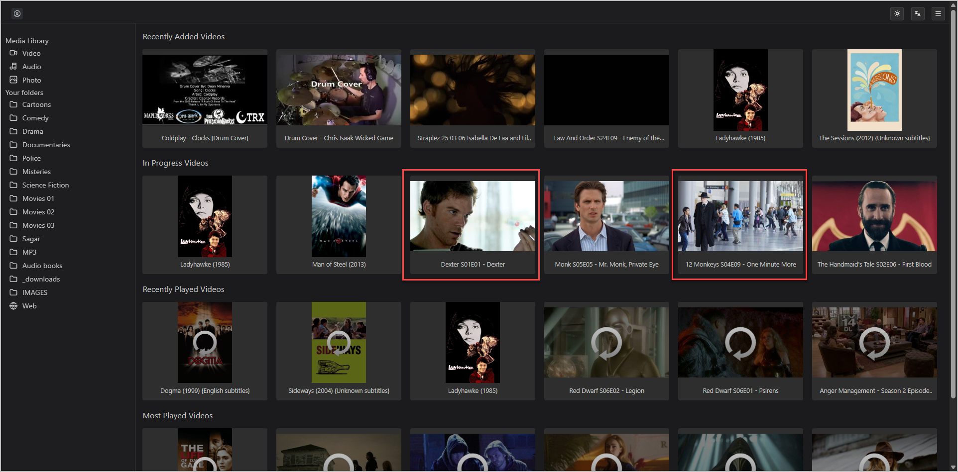

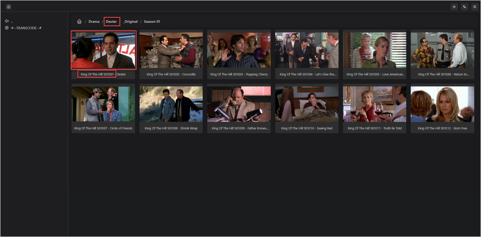

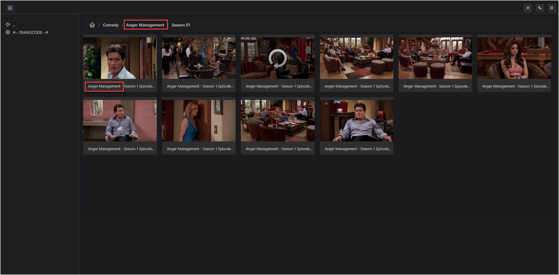

I have been having this issue for a few months, I'm not even sure when it started. It's about wrong episode names and sometimes thumbnails, like this:
As you can see, it's a Dexter episode with Monk thumbnail and King of the Hill name. I have cleared the cache several times, but things only change a little; it's never completely fixed.
Not all files are affected, though:
Anger Management.png (638.16 KiB) Viewed 295844 times

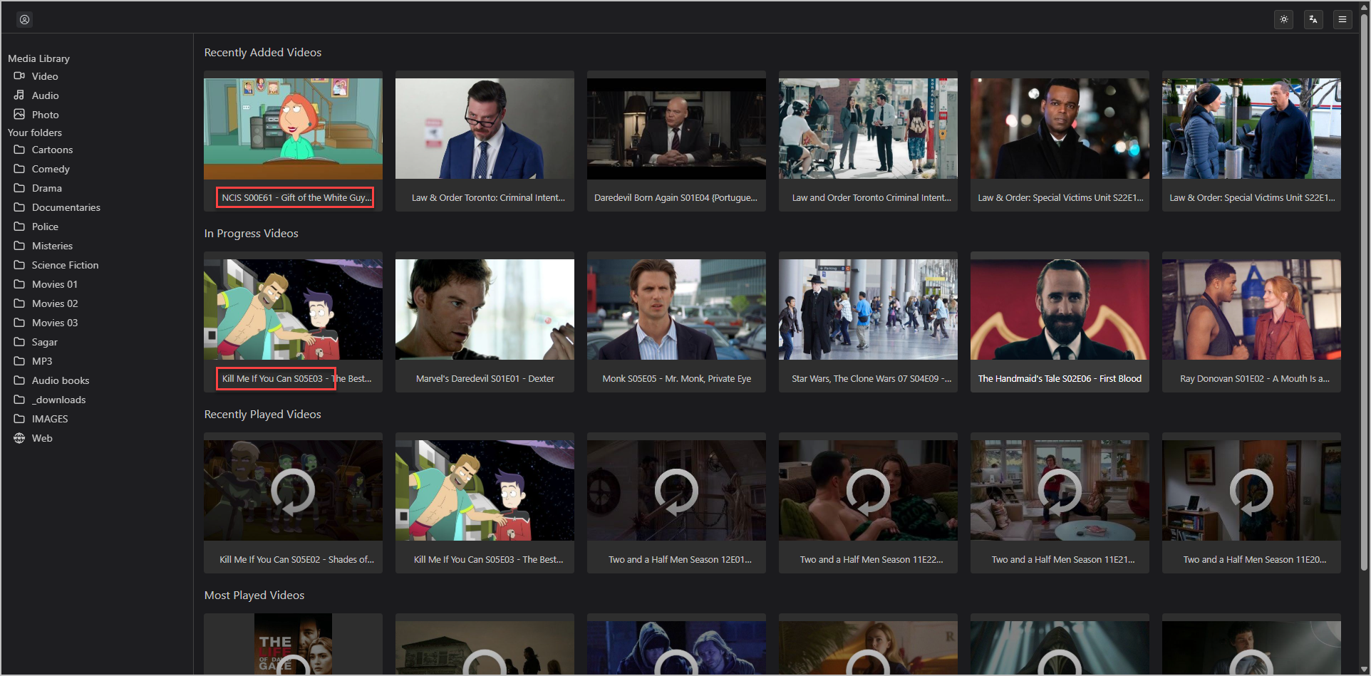

In this image, you can see that Family Guy is wrong, but it was right before the cache reset. Lower Decks didn't change, it was wrong both times:
Right to wrong.png (1.2 MiB) Viewed 295844 times

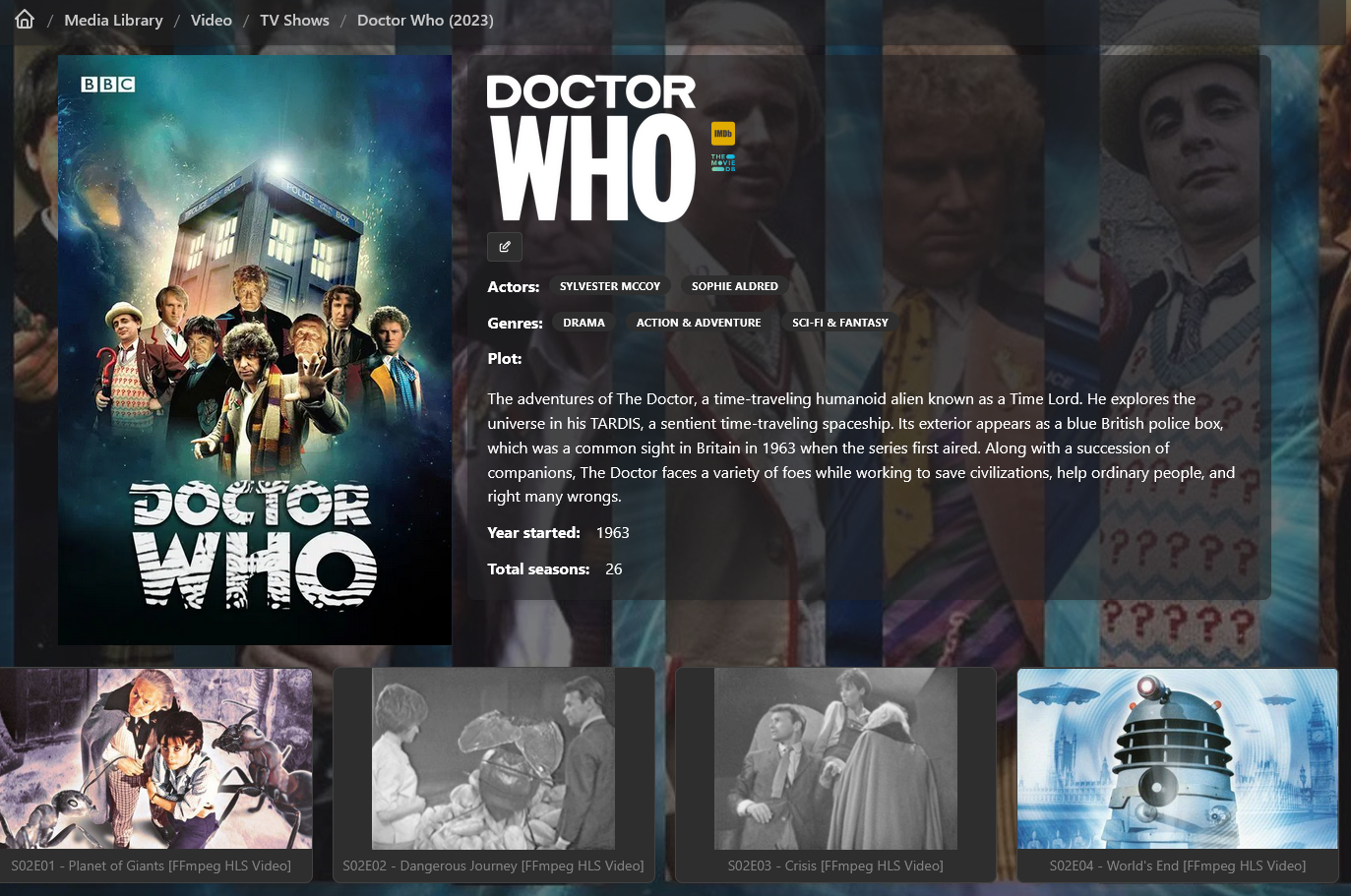

I came across something recently where the wrong episode names and thumbnails was coming up for the new Doctor Who so there may be an issue on the API side of things not retrieving the correct metadata (does not help they reset the season number with the new Doc).
Screenshot 2025-05-16 144634.png (1.57 MiB) Viewed 294727 times

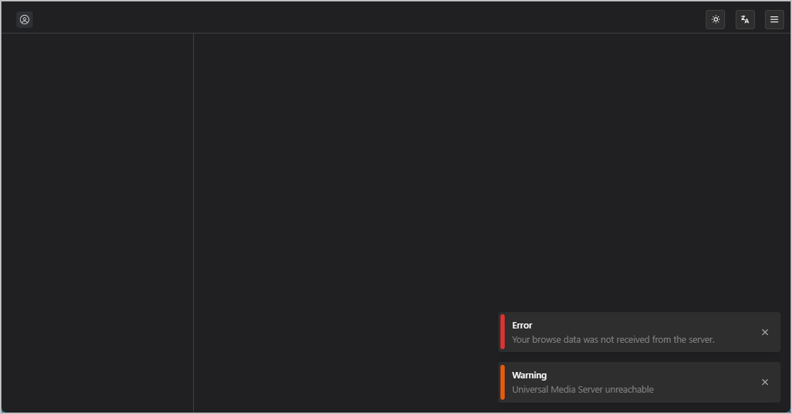

I finally had time yesterday to test the new version. At first it was all the same as before and then I clicked on Clear Cache. It was acting weird, I had to click several times until it worked. Then the server restarted and it was unavailable, but using the old intercace I could see it was recreating the cache. It took a few hours to finish. This morning I tried to check it but the server was unavaliable:

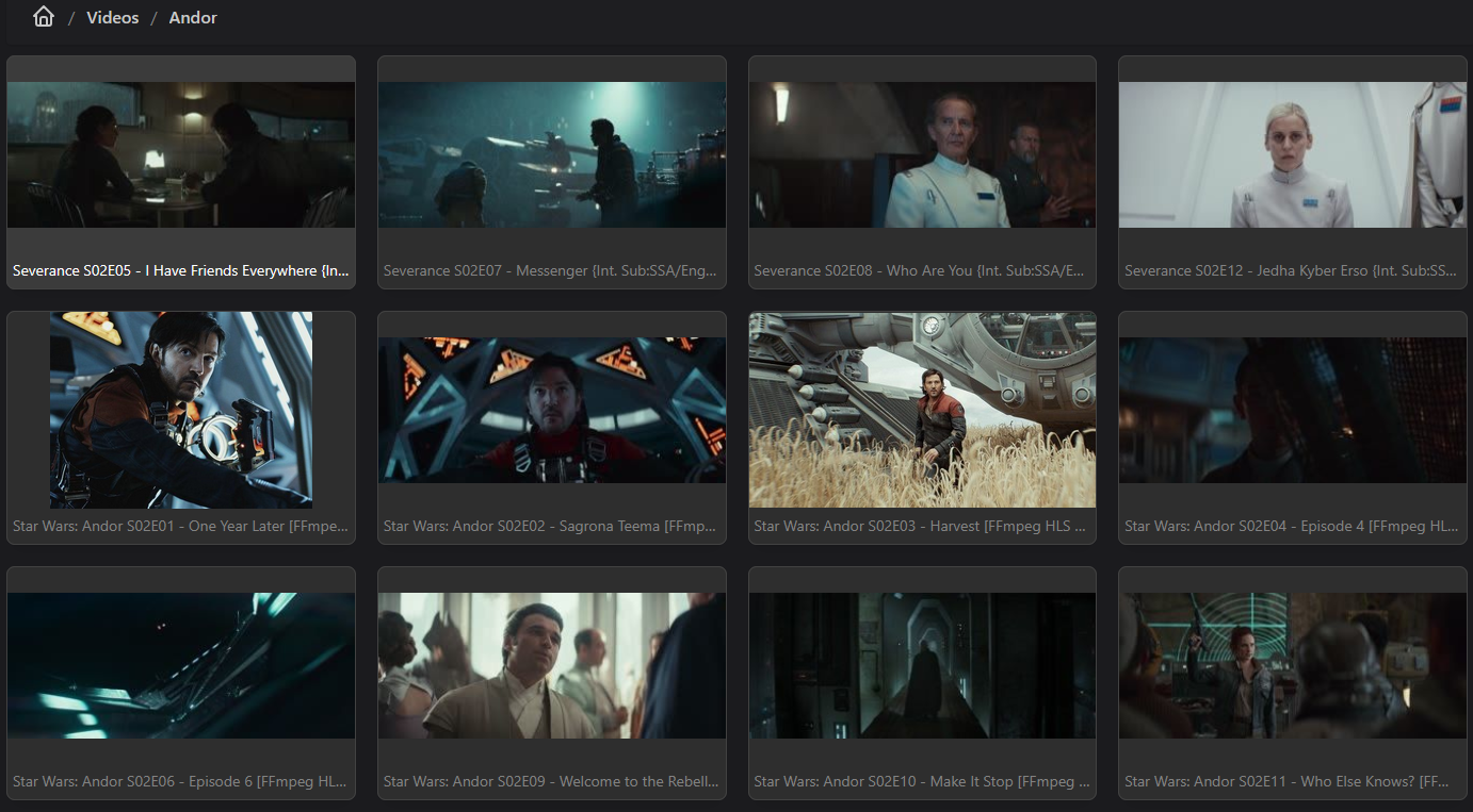

I tried restarting it, no change. So I reinstalled the previous version, 14.12.1, and all seems to be displaying fine:
