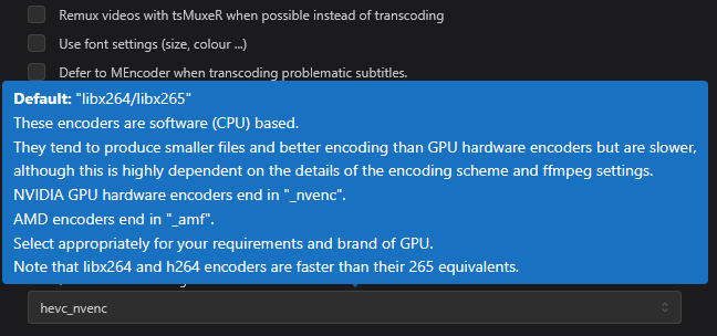

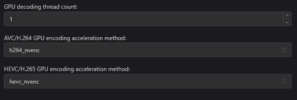

If you have a GPU that has a video encoder you can enable this in the transcoding settings for FFmpeg. It may be possible that the video can be streamed unaltered and the TV will just crop it to fit.

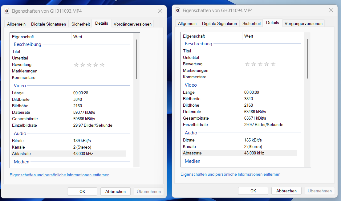

Could you please take a look at the following test case? There are two videos GH011093.MP4 and GH011094.MP4, both in the folder /GoPro/Chateau 03-2025. They are both 4K videos, please find the screenshot attached, but the first one can be played on my TV, while the second one is being shown as MPG file with 0 byte size (please find photo attached) and can't be played. I hope that fresh log files will help. Many thanks!

Video "GH011094.MP4" is not streamed due to the bitrate being higher than the estimated bitrate to the TV
The TV also has a max bitrate that it is able to play for h264 set at 60Mb/s so it would not be able to play even if the speed was faster.
You can see the specs here and your TV is in group 23TV_PREMIUM3
For this one it will work if you re-encode to h265 as that can handle the higher bitrate of 80Mb/s.
