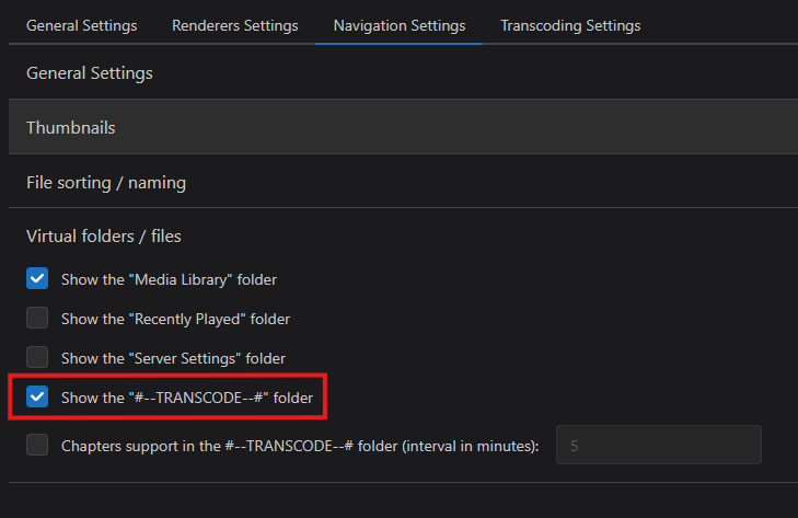

Re: Apologies for a VERY noob question. Subtitles not shown.
By device I mean the thing the video is playing on.
For example My F series Samsung TV and my PS4 don't support PGS subtitles so these need to be burned in.
If it had subrip subtitles they both support this so can be enabled directly on the renderer.
If subtitles are not supported and need to be burned in it is your computer running UMS doing the work.
As there is no way for the renderer to tell what subtitle to use UMS makes that decision depending on your settings or you have to pick the subtitles you want at the start from the transcode folder if not done automatically and cannot be changed half way though without restarting the video.
You will also need to pick the right audio track too as it could have many. All combinations of subs, audio, and transcoding engine should be available.
If you cannot see the #--TRANSCODE--# folder you can enable it in the settings. It should appear on all renderers.

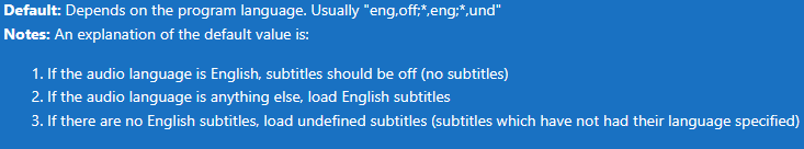

If you always want subtitles on you can change the Audio/subtitles language priority: option.
The default is set depending on your system language but you could remove the eng,off; part so it is just "*,eng:eng,und" for example
