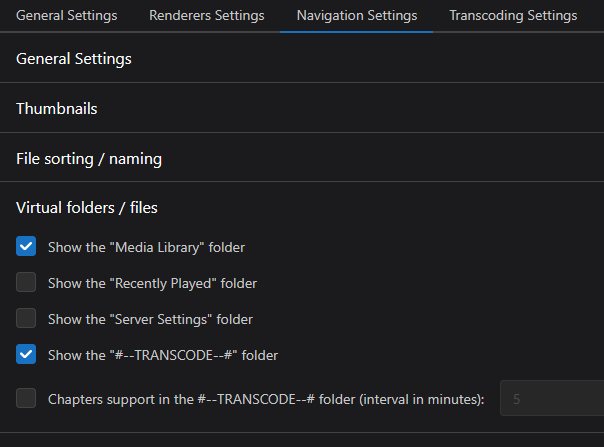

One way to test this is to play from the #--TRANSCODE--# folder and choose "No Transcoding".
If it will not play then UMS is doing the right thing, if it does then the conf can be tweaked to add that format as supported.
If you do not see this folder then you can enable it in the settings.

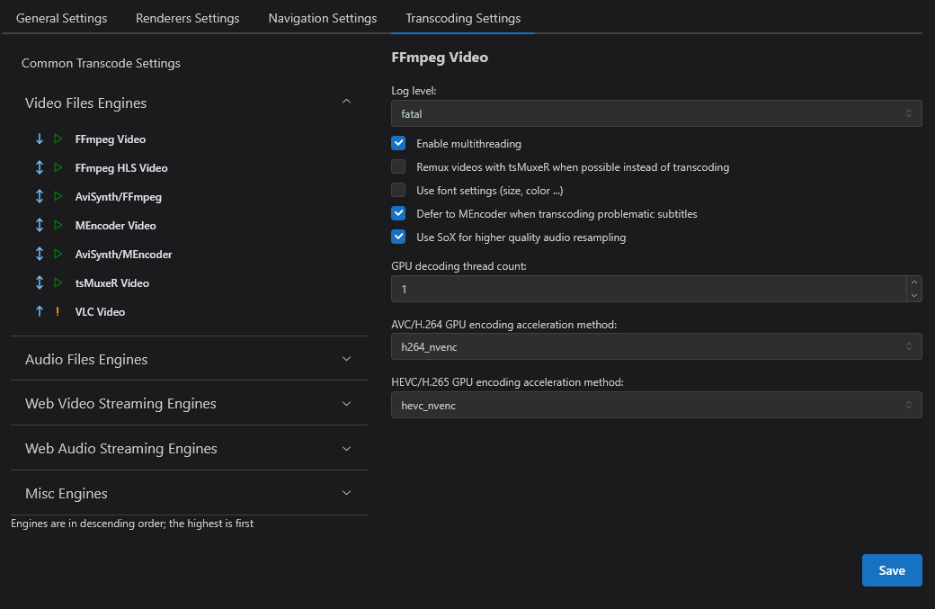

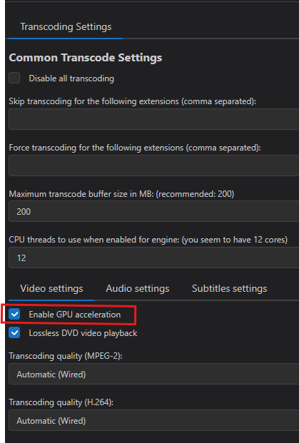

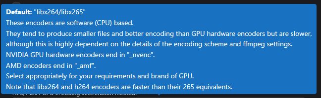

If you have a graphics card that can hardware encode you can enable this and let it do all the work.
Make sure the GPU is enabled and set the "AVC/H.264 GPU encoding acceleration method:" to a suitable option for your GPU.
Screenshot 2025-10-23 090300.png (27.64 KiB) Viewed 250911 times
