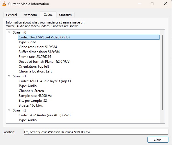

I have a Q60 series Samsung TV, I tried to stream some tv shows from my pc, but it does always fail due to network problem. I can see all the files and the thumbnails also generated, but the playback fails. On my computer the webplayer works normally. Is it a settings problem?
I attached a picture about the codec.
I have the latest UMS version: 15.1.0.

Those videos use the DIVX codec that is not supported on your TV so these are transcoded.
One thing UMS was doing is if one of the streams in a video is supported then instead of transcoding that stream it remuxes it to reduce the amount of processing needed.
However it was not long ago that we found that for some devices the transcoded stream has to match the transcoding profile so if there is a mismatch by remuxing a stream even if on its own is supported then the device can fail to play.
In this case the audio is MP3 which is supported so was being remuxed, but the transcoding profile is set to AC3 so it confuses the TV as this is what it is expecting.

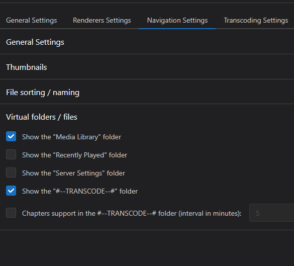

Play them from the #--TRANSCODE--# folder and chose one of the options there. You currently have this hidden so you need to enable it in the settings. For those AVIs you can confirm your TV can't natively play them by selecting "no transcoding".
