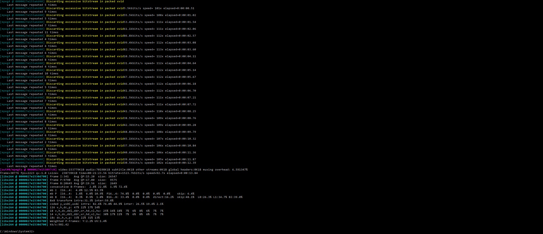

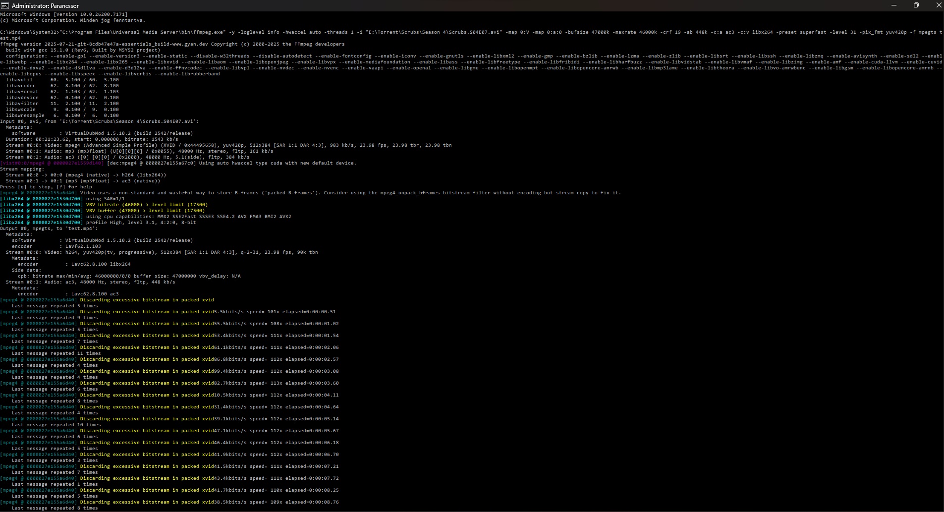

Here are the pictures of the CMD prompt.
You know the funny thing is if I'm using the Windows Media Player Legacy (after I made a playlist) I can stream the video to my TV without any problem. For some reason UMS has a problem with these videos.
- ums1.jpg (409.16 KiB) Viewed 45549 times
- ums2.jpg (318.82 KiB) Viewed 45549 times

The output from FFmpeg is a bit unusual from what I am used to. It says it is discarding some excessive data in a packed steam.
Maybe the way these videos was encoded is difficult for the current way UMS is transcoding or even if it can in the current state.
I did find some information about DivX/Xvid on Samsung TVs and how it might be possible to trick the TV to playing them by changing the codec ID.
For packed bitstreams you can use FFmpeg to decompress and reorganise it to make it compatible without needing a full re-encode.
The instructions on how to do this are here with a lot more information about this but I only read the first few posts. It looks like someone has made a script to automate the conversion too.
You might have to try playing these converted videos using "no transcoding" first as I don't know if UMS can detect this change to be able to set this in the conf as supported.
If they do then it would help to see logs of it trying to play normally and with no transcoding to see if I can make the tweak.
However normal transcoding should now work on them.
