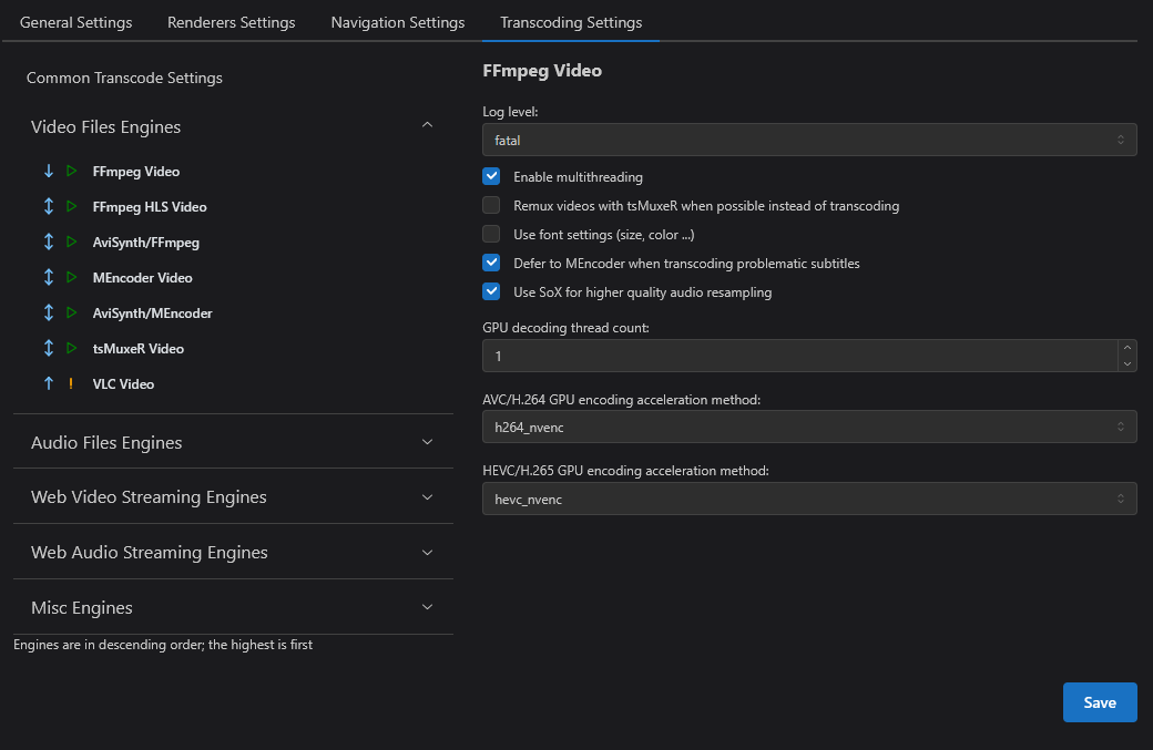

ffmpeg doesn't show up in the regular logs when I click play video, and the drop-down for ffmpeg encoding acceleration method only lists:
libx264
h264_nvenc
h264_amf
h264_qsv
h264_mf
libx264rgb
I tried adding to UMS.conf with no success:
ffmpeg_path = /usr/bin/ffmpeg
ffmpegHwAccel = vaapi
How can I get ffmpeg to have vaapi displayed in the dropdown so it can be used by the appimage?

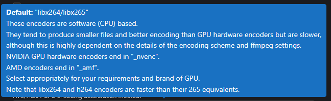

As it is an AMD GPU you will need to set the acceleration method to the ones ending with "_amf". You could also set this as I think the actual default is none, I saw a pull request about this the other day.

There is no option for "ffmpegHwAccel".
When UMS is initialised it will run FFmpeg to get the available acceleration methods and store them in UMS.conf.
ffmpeg_gpu_decoding_acceleration_method =autoTo use the system ffmpeg then seting its path should make it work.
