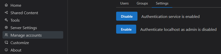

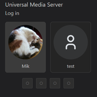

You can enable authentication settings so you need to log on to access the settings and there is even a setting to automatically log in as admin on the computer running UMS.

When you first installed UMS, or updated to the version that added this, you should have been asked to make an account for Admin.
It does allow you to ignore this and turn authentication off but it should prompt you again if you enable it.
If not there is a way to reset this that I can walk you though.
Only Admin has access to the settings but you can set up user accounts for each person so it saves their played status in the player and allows you to restrict access to certain folders.
Accounts can be linked to a renderer too so it does not just apply to the web player.
