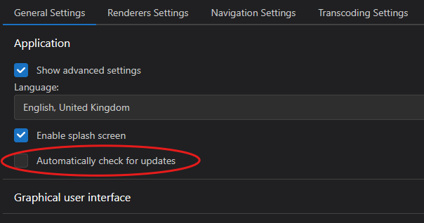

If you have check for updates enabled then it should tell you when there is an update and how to do it although I never use it as I use the test builds.

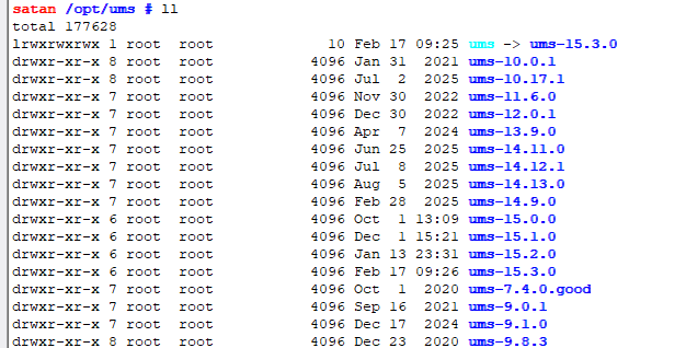

This is the way I do it but it is on a Gentoo headless server. I see no reason why it would be any different on a headless ubuntu.
AS long as you are comfortable with command line commands.
**The install folder is /opt/ums/
Under that I have many different versions of UMS in their own folder.
When I want to add a new version, I copy the Linux Tarball to /opt/ums/
Then from the /opt/ums/ folder extract the Tarball
For 64-bit linux and UMS v 15.4.0 that would be:
tar -xvzf UMS-Linux-15.4.0-x86_64.tgz
That will create a folder (ums-15.4.0) under the folder /opt/ums/ with all the files in it.
EG (a few as an example):
ums-10.0.1
ums-12.0.1
ums-14.9.0
ums-15.3.0
ums-15.4.0
Then I create a soft link under /opt/ums/ to the version I want to run.
EG (for ums-15.4.0):
In the folder /opt/ums/
ln -s ums-15.4.0 ums
That way, any start up scripts you have, you just point it to /opt/ums/ums which will run the version you have linked.
If you want to run different versions, you just delete the link with the command: "rm ums"
And then create another link to whatever version you want to run.
**PS.. The configuration files are not in "/opt/ums/ums version".
When you add a new version or link to a different version, the configuration files remain intact and do not need to be setup again.
These configuration files are normally in /USERNAME/.config/UMS/
