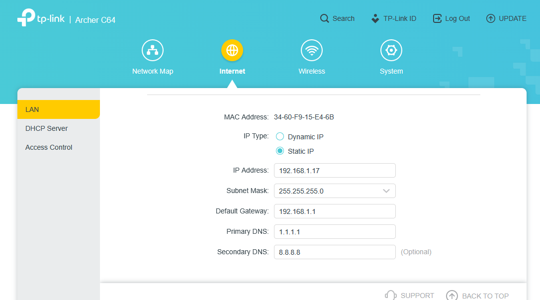

A good router/access point which is good value is the TP-Link Archer C64. I have setup many for people. In one apartment block I have placed 14 of them and they work great. If your budget permits, would definitely upgrade the WR840N.
Where I live in Bali, Indonesia I buy them for US$30 each.

Firstly start by turning back on DHCP on the HG8145V5 and disable it on the WR840N.
If you really don't want to have the HG8145V5 performing DHCP functions, you can also buy something better to replace the WR840N and run it in access point mode with DHCP enabled.
But... all DHCP does is hand out LAN IP addresses to your local devices. If your ISP was "spying" on you, it makes no difference if the HG8145V5 or the WR840N is performing the DHCP functions.
Something which is worth doing is to use other DNS than the ISP's DNS.
In the DNS settings use 1.1.1.1 (Cloudflare) as your primary DNS and 8.8.8.8 (Google) as your secondary DNS. (see attached screenshot).
In regard to the DHCP and manual IP on your MAC's.
In MacOS, if you have a manual IP, that is the IP and it won't be allocated an IP by DHCP even if DHCP is on.
If you have DHCP off, you need to input the DNS and gateway information manually.
If DHCP is on, the DNS and gateway information automatically received from the router.
If you need any help with the setup and you have WhatsApp, let me know in this chat and I will send you a private message with my WhatsApp phone number.

- Screenshot 2026-03-19 134310.png (129.72 KiB) Viewed 214556 times
