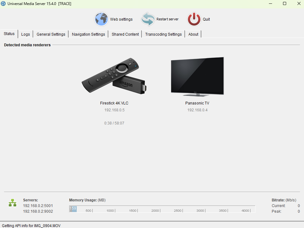

Re: Files no longer supported on VLC on Firestick
OK I think because it was sending 2 different User-Agent headers only the first one received was being matched but that one is very generic so did not try to use it before.
I have added something that should match the first one too but I suspect if it ever has a firmware update this would change and has a possibility of matching other devices too.
User-Agent: Linux/4.4.120+, UPnP/1.0, Portable SDK for UPnP devices/17.2.0
User-Agent: Dalvik/2.1.0 (Linux; U; Android 7.1.2; AFTMM Build/NS6711)
That one did the trick, you're a star! Thanks for all your help with this and pointers what to look for if the firmware changes.mik_s wrote: ↑Wed Mar 25, 2026 12:37 am OK I think because it was sending 2 different User-Agent headers only the first one received was being matched but that one is very generic so did not try to use it before.I have added something that should match the first one too but I suspect if it ever has a firmware update this would change and has a possibility of matching other devices too.Code: Select all
User-Agent: Linux/4.4.120+, UPnP/1.0, Portable SDK for UPnP devices/17.2.0 User-Agent: Dalvik/2.1.0 (Linux; U; Android 7.1.2; AFTMM Build/NS6711)
