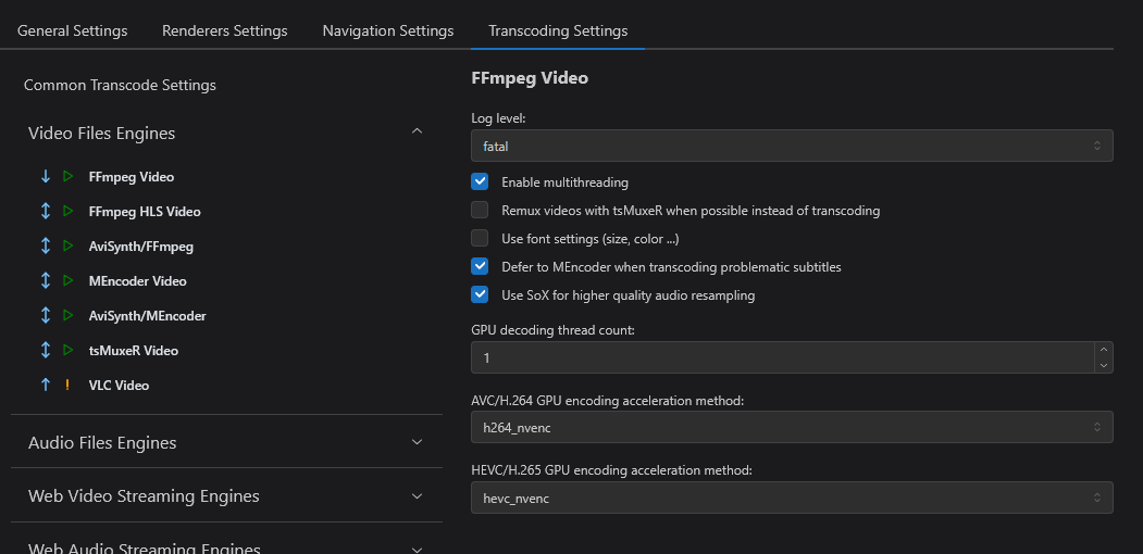

I did check the FFmpeg settings and GPU decoding is set to "none" so (since I have a decent Video card) so I set it to "enable GPU acceleration" in the "common transcode settings" tab.

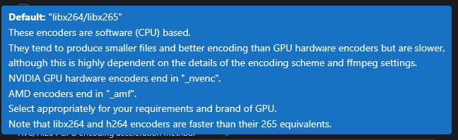

Also set the GPU acceleration method for FFmpeg to allow hardware encoding too as just enabling the GPU will use it in assisting but most of the processing will be done in software (CPU).
Pick the one appropriate for your GPU.

You could try and turn off "Use automatic maximum bandwidth" and set "Maximum bandwidth" to 0 which means unlimited, then try and play with and without "no transcoding" and see if the TV attempts to play.
