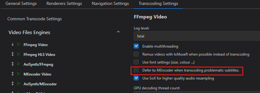

Re: Lag between audio/video with latest versions
Audio/video sync problems is usually down to using MEncoder for the transcoding engine.
I don't know why this has these problems though.
I can see that it should be using FFmpeg but is switching to MEncoder because of a setting with subtitles.
This is not set in your configuration but the default setting is true
# Defer to MEncoder when transcoding subtitles
# Whether FFmpeg should defer to MEncoder when there are subtitles that need
# to be transcoded.
# Both engines can handle subtitles, but MEncoder is more stable right now.
# Default: true
ffmpeg_mencoder_problematic_subtitles =
Turning this option off should fix it so it will just use FFmpeg.
Screenshot 2026-02-26 104213.png (32.32 KiB) Viewed 193843 times
I think the main reason for this option is because FFmpeg can take a little longer to start up if it has to parse subtitles so the device can timeout before it gets the video data.
If this happens, playing again immediately should work as the subs have been cached so starts faster.
There has been some issues we have been trying to track down with transcoding stopping after a few seconds on some devices and I think one report of this happening was on the PS3.
If this starts to happen I suggest using an older version till this is fixed.
I have tracked the problem down to version 14.7.0 for the devs to figure out why it is happening, so try the version before this.
