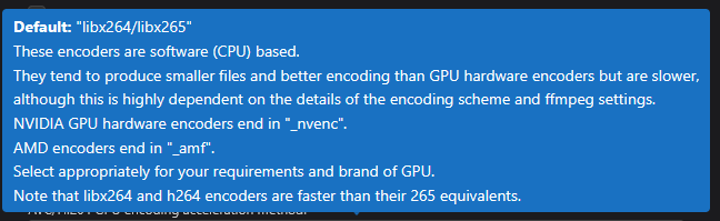

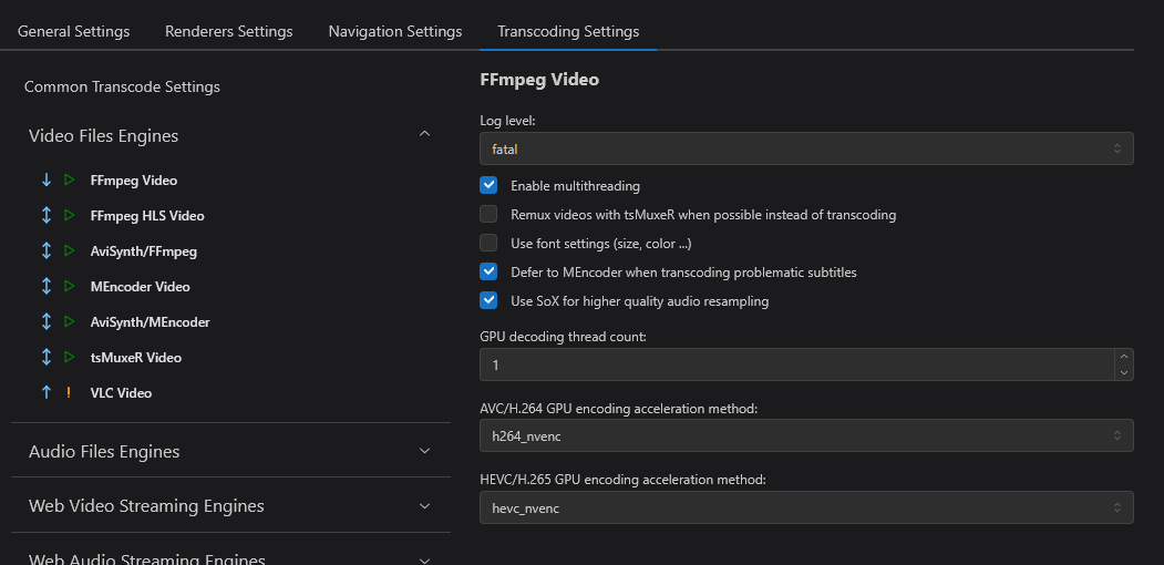

Since that conf is using the MPEGTS-H265-AC3 profile (needed for 4k content) for transcoding you really need to use the GPU to do it in hardware as it takes a lot of processing.
That is probably the cause of it not working well for those unsupported formats.
If you have a GPU that has its own encoder you can enable HEVC/H.265 GPU encoding acceleration in transcoding settings and enable the GPU.
Or if you never intend to play 4k then you can change the transcoding profile to MPEGTS-H264-AC3, but I think the vp9 codec is used for 4K.

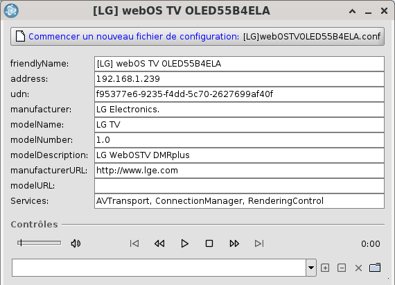

Re: LG 2024
The Conf file was not recognized
- Capture d’écran_2026-09-12_15-21-51.png (34.64 KiB) Viewed 9035 times

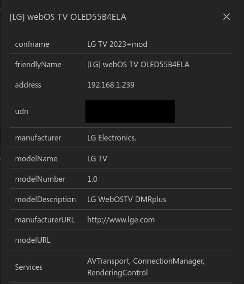

Re: LG 2024
That info box on the old GUI does not show what conf is being used.
With what little French I know it says something like "start new configuration file" and the filename it would use.
Check the WebUI info for a renderer and it will show the conf used. Your logs should also show what is being used.
I always add "mod" to confs I have changed so I can see if it is being used over the original.
I am not 100% sure the renderer folder is correct on Linux but should be inside the same folder as your UMS.conf file which is where I got that path from.

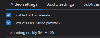

Re: LG 2024
Does it work better for those videos that use lpcm and adpcm codecs? It should stream unaltered and not transcode.
Did you change the acceleration method for your GPU so those that have the vp9 codec can transcode faster?
