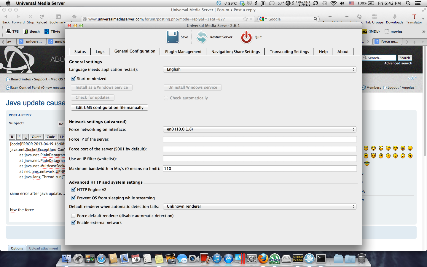

Re: Java update causes error
got the same error... after java security updata....
btw, Force networking on the server en1xxx.xx.xx.xx not working for me ^^;
plz fix it and sorry for my bad english^^
ERROR 2013-04-19 16:08:39.591 [UPNPHelper] UPNP network exception
java.net.SocketException: Can't assign requested address
at java.net.PlainDatagramSocketImpl.socketSetOption(Native Method) ~[na:1.6.0_45]
at java.net.PlainDatagramSocketImpl.setOption(PlainDatagramSocketImpl.java:309) ~[na:1.6.0_45]
at java.net.MulticastSocket.setNetworkInterface(MulticastSocket.java:536) ~[na:1.6.0_45]
at net.pms.network.UPNPHelper$2.run(UPNPHelper.java:363) ~[pms-1.80.0.jar:na]
at java.lang.Thread.run(Thread.java:680) [na:1.6.0_45]btw, Force networking on the server en1xxx.xx.xx.xx not working for me ^^;
