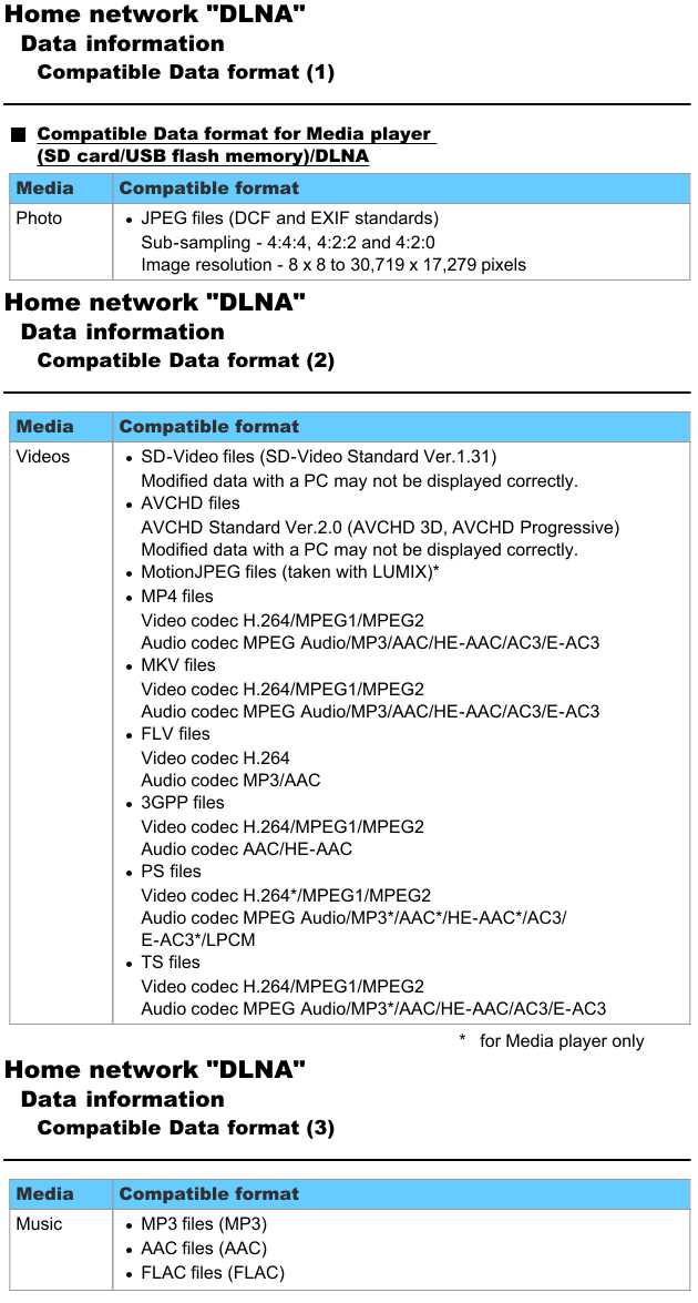

So, using the PS3.conf file as a guide, I edited the Panasonic.conf to match the specs of supported formats in the UT50's manual (I'll upload screenshots). I don't know if I'm really doing it right, but now it seems my Panasonic works better than before - I think I used to transcode everything because the buffer would always fill up when watching, and now I've learned about streaming since everything plays instantly w/ no buffer and I can seek with greater detail--but my MKV files aren't working at all! Yet they did before, obviously. I assume because the audio is FLAC, it's not recognized by the Supported settings, so it shows "!" and "Cannot read file".

Below I'm attaching screenshots of the UT50 manual showing supported formats, uploading my Panasonic.conf so you can see if I'm doing something wrong, and I'm uploading my debug of me attempting to play the MKV file with my Panasonic.conf edited with "StreamExtensions=mkv". Normally, I would think to not have that in the CONF file and would think it should just remux or transcode automatically if it doesn't match the Supported settings, right?

- UT50SupportedFormats.jpg (94.47 KiB) Viewed 8654 times
