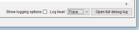

I was just saying confirm that it says Trace on that screen and if not then change the dropdown to trace and quit and restart UMS, then repeat the steps to replicate the problem like pressing restart server till UMS appears on your PS4 then try to access it on the PS4 before packing the logs.

Sorry dude what screen do you mean with trace. Can you post a screenshot. yep I am a dummy lol thanks
update: nvm I found what you are talking about and will post the bug again later. Thanks for all your help

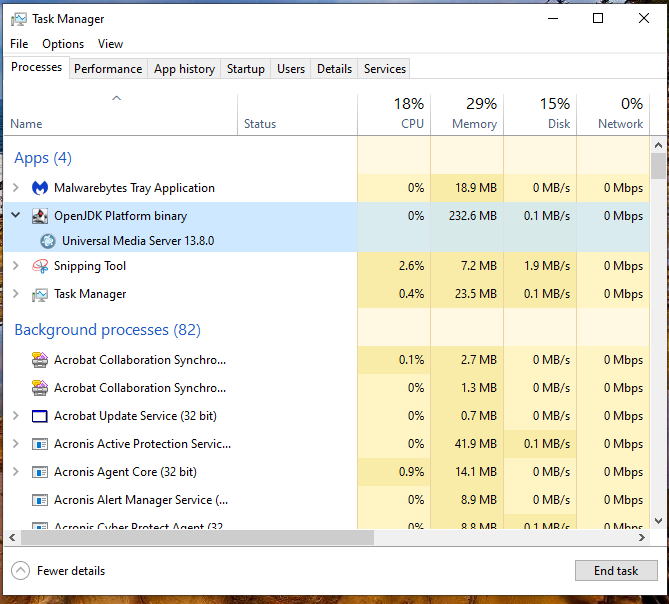

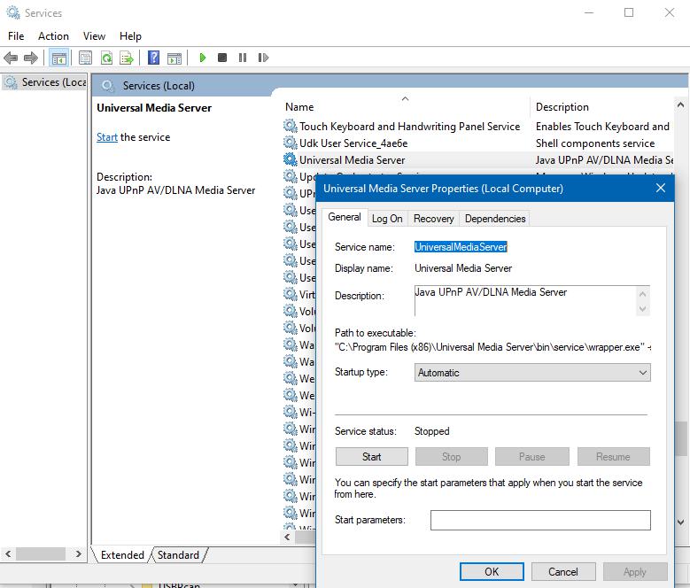

When I was saying check if UMS is running I meant in the processes tab in task manager (I have not used it in so long I can't remember much about it), but that screenshot of your services is helpful and may give a clue.
There is a UniversalMediaServer service there which means at some point you have ran UMS as a windows service, and this will cause conflicts when running UMS normally or trying to uninstall it. That would also explain the 2 instances of UMS on your TV.
That option is for advanced users that know what they are doing for certain situations, and I'm not one of them.
I'm not sure how this works either as its not an option in the conf, it probably installs a version of UMS into the windows services.
Try running "services" from the windows search bar and look for the UniversalMediaServer service and see if you can remove it. I'm not on a windows computer to confirm the exact steps though. If that works you should be able to uninstall and reinstall UMS normally.
Once I'm back home I'll be able to go over them and hopefully see the problem.

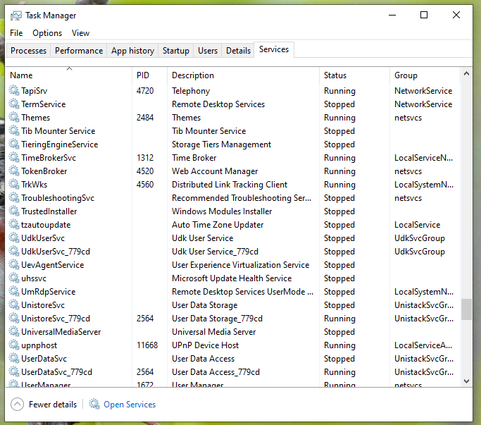

Update: After a more detailed search for UMS under processes. I blew right by it numerous times and the happen to see jdk which I do believe is java and when I click on it the window drops down and UMS is present. Hopefully with the info I have provided we can work this out finally. Thanks again for all of the help you are providing

Unfortunately the trace logs did not reveal the problem like I thought, or is something I missed. I was hoping to see a message saying a file or port was in use.
I tested the install as service option on my computer and it does appear in the services and the same keys appear in regedit. I thought the option "install as service" would change to "uninstall service" on the old GUI but it does not. It might have done on old versions and is broken now, or it never did this.

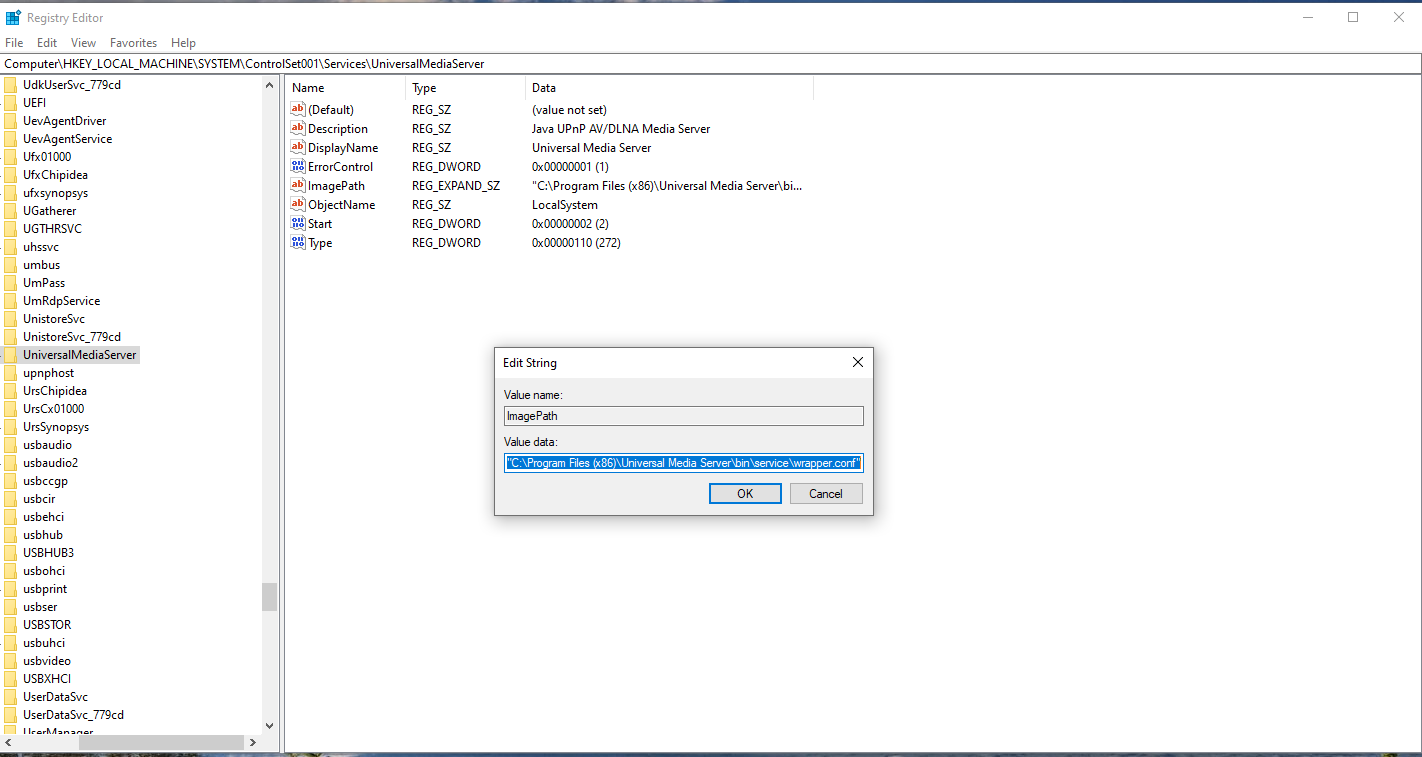

I found this guide on uninstalling a service.
Might be easier to open a CMD prompt in admin and run "sc delete UniversalMediaServer" which should return "[SC] DeleteService SUCCESS".
I just tried it and it does remove it from my services after refreshing it.
I think because it was installed as a service at one point it is causing all these problems so definitely delete it and reboot your computer then you should be able to completely uninstall UMS and reinstall selecting the clean install option to remove all traces of the previous install. Once UMS starts your web browser will open so you can set the login details for the web settings if all goes well.
