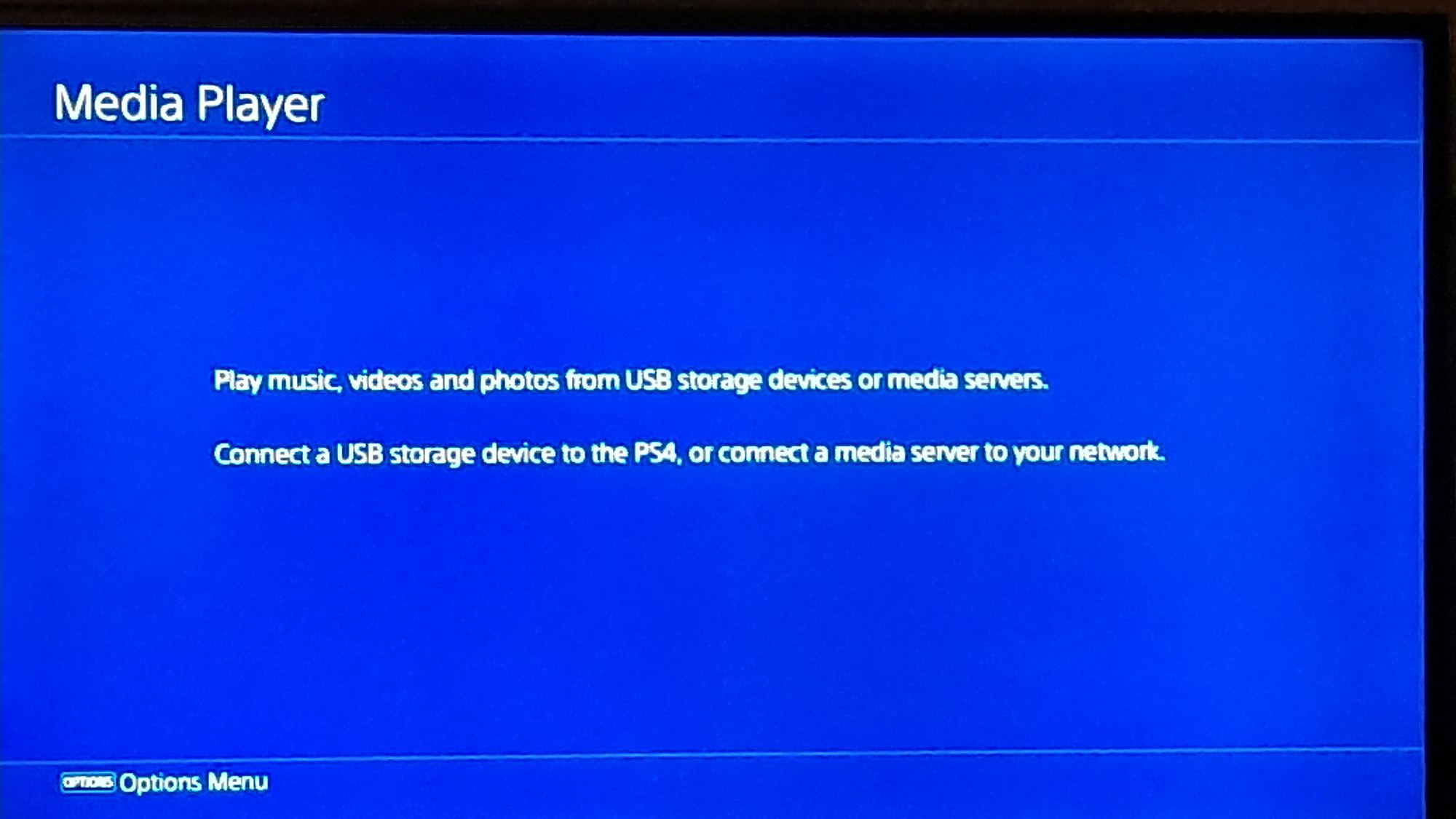

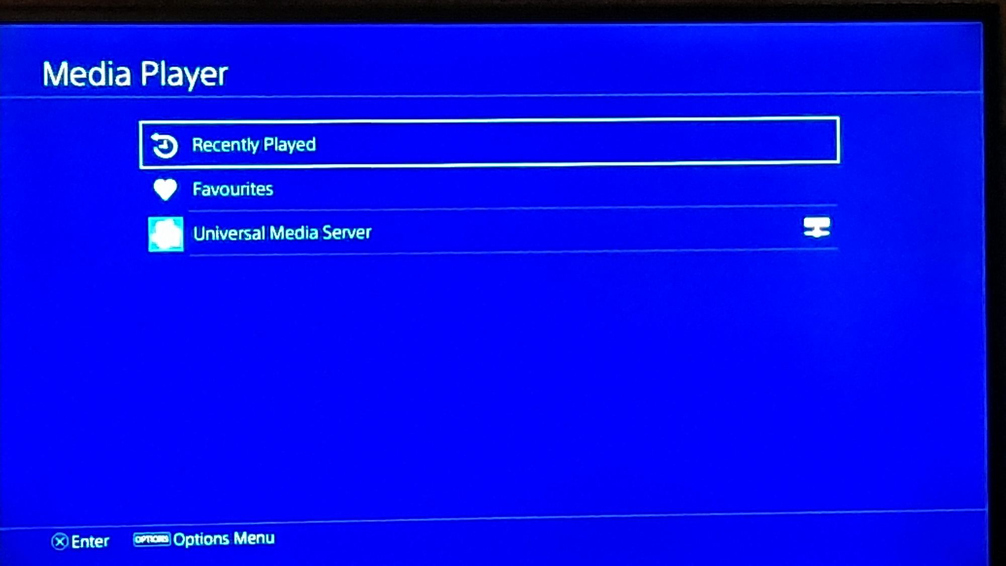

If you have the PS4 media player open before starting UMS it will look like this
Then when you start UMS it will change to this.
Don't hit the restart button, just wait a bit till UMS has time to find renderers. If nothing comes up after several minutes then pack the logs then and I will see why nothing is being detected.

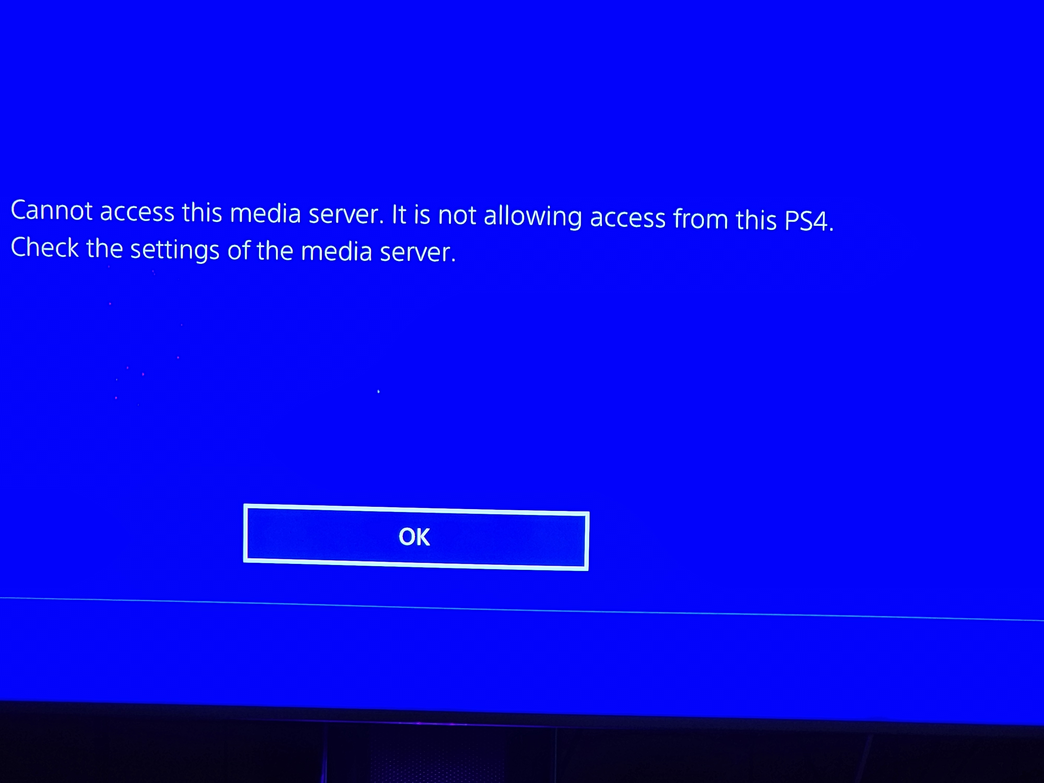

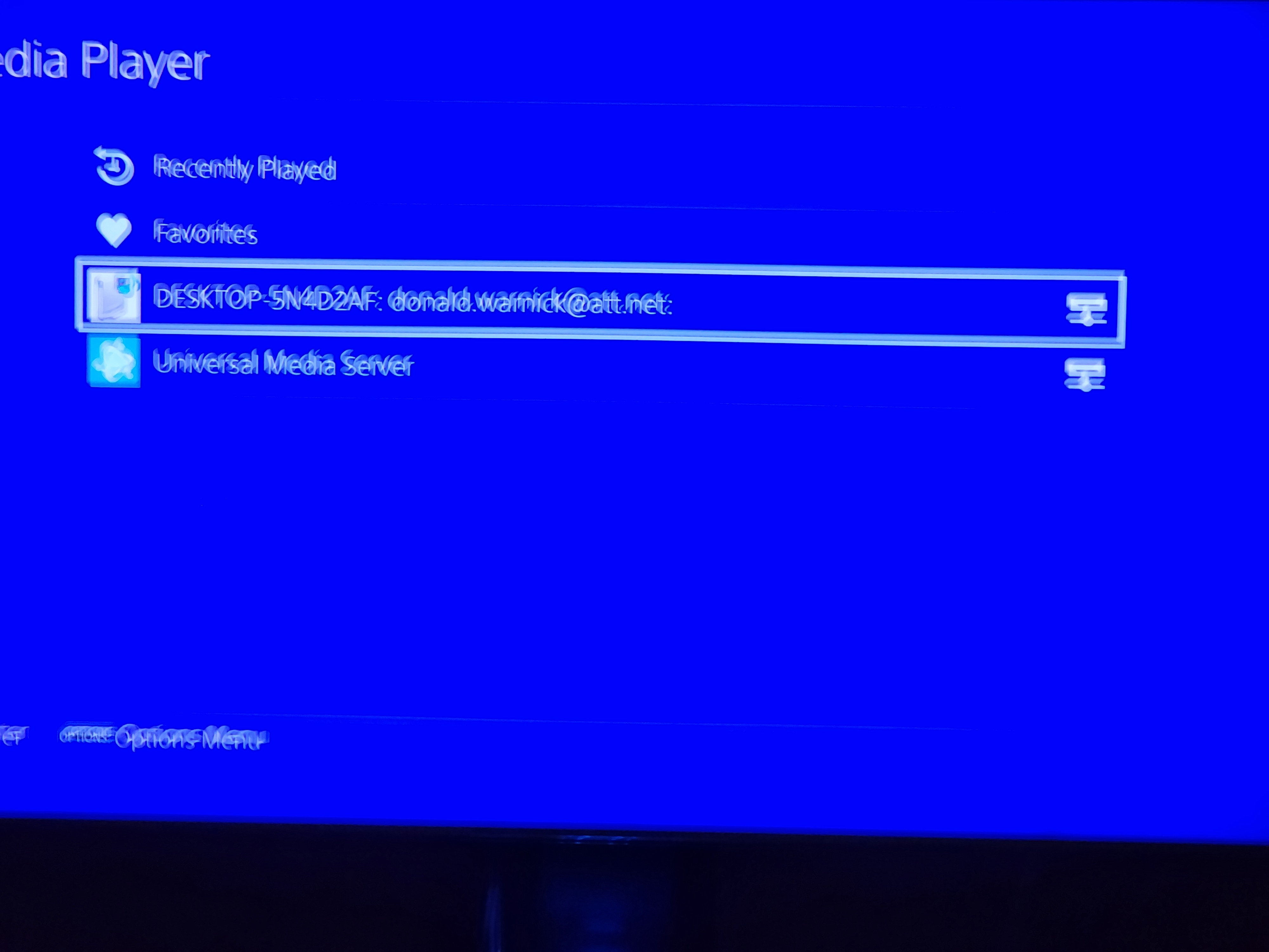

Oh my goodness I do not think I understood you correctly. You want screen shots from my tv of my ps4 showing UMS. Is that correct? I selected the folder I wanted UMS to scan when it starts up but every time I close UMS it clears the checked box for shared folders so when I reboot my pc and UMS starts up and I open UMS it shows the shared folder box unchecked so no way for it to scan. I am gonna take a couple photos of my tv when my ps4 boots up to show you that UMS is there but is not communicating with my pc. Sorry if I am getting all this wrong but I am trying to explain and understand you as well. I am also going to take a photo of my samsung tv finding UMS but no folder with the movies is found so I honestly do not know if they would show up on my tv if the box for shared folders would stay checked when I reboot my pc. Yep i am 100% lost and I apologize for my ignorance sorry about the bad photos but I am sure you can see what you need to.
- ums_dbg_2024-01-04-16-47.zip
- (49.76 KiB) Downloaded 579 times
- 20240104_154048.jpg (902.02 KiB) Viewed 28296 times
- 20240104_153910.jpg (862.7 KiB) Viewed 28296 times

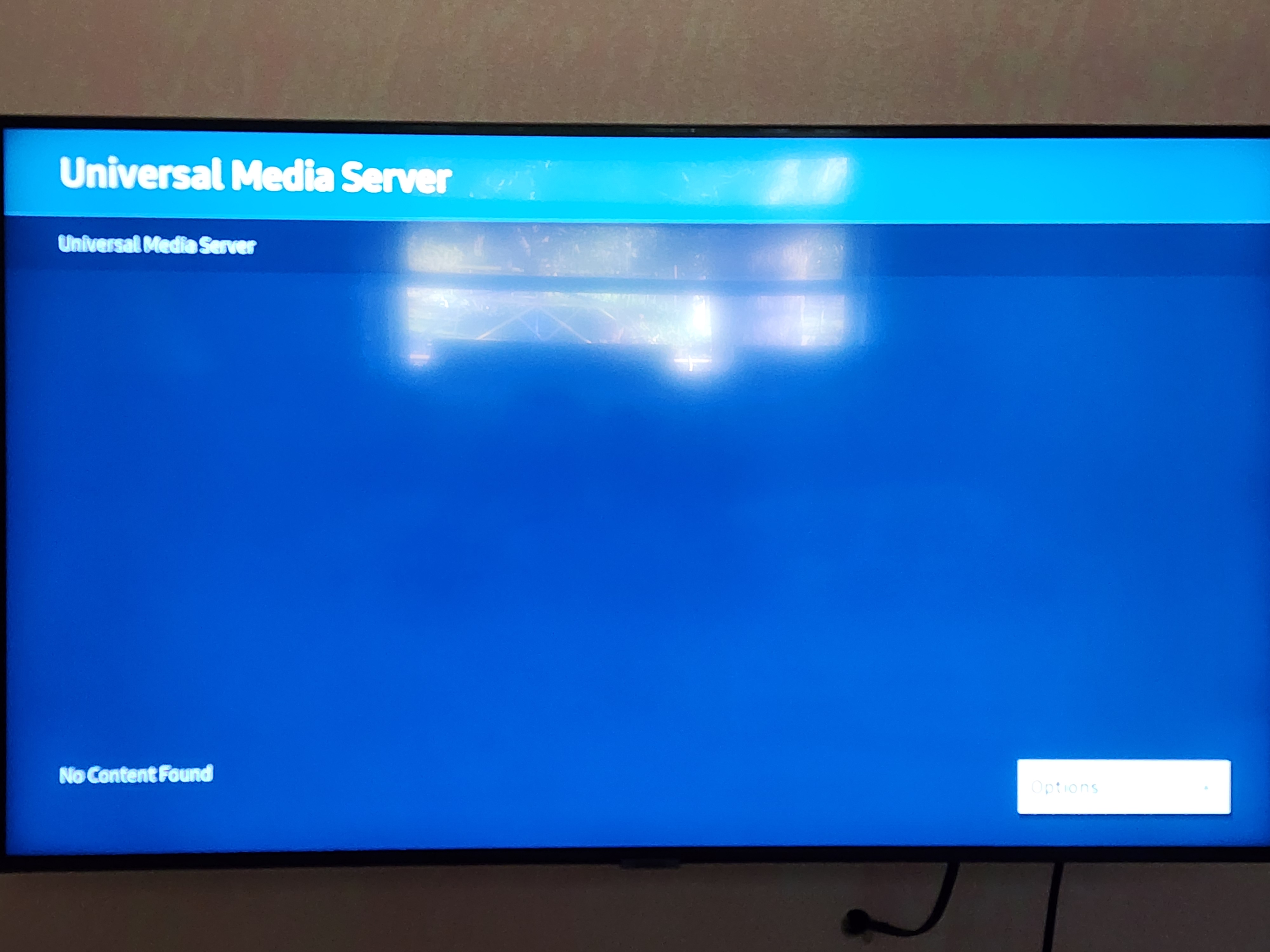

This pic shows the response I get on my samsung tv when I open UMS.I replaced the debug file with the new one. Thanks for all your help
- 20240104_161915.jpg (1.32 MiB) Viewed 28295 times

From the picture UMS is detecting your PS4 so it should be working. Maybe something on your computer is blocking some of the communication.
Do you have a separate antivirus/firewall? Try turning it off or make sure UMS has access though it.
