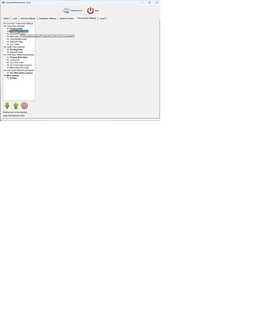

Attached is a screenshot of the FFMPEG HLS Video 0.0.0.

- FFMPEG HLS Video (0.0.0)
- ffmpeg.jpg (58.77 KiB) Viewed 51387 times

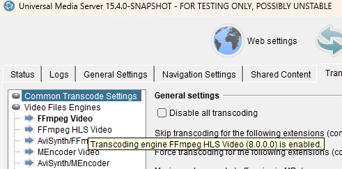

That FFMPEG HLS tooltip does not show on the web interface so I checked the old GUI and for me it is showing 8.0.0.0
It shows the same thing for FFmpeg Video and AVIsynth/FFmpeg engines

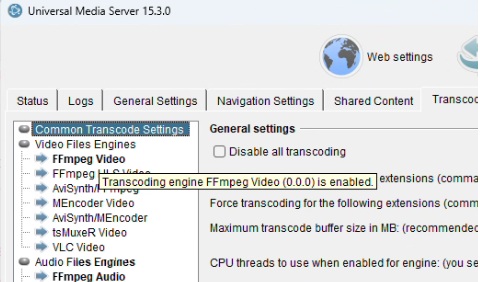

Ans: ALL my engines are showing (0.0.0), except for VLC Video, which is showing (3.2.1). Re: Do the videos stream in the previous versions? Will there when playing from the #--TRANSCODE--# folder but selecting "No transcoding"

The tooltip version is probably due to the version number in FFmpeg, and all engines that have FFmpeg use the same exe file.
The previous one had a date where in mine it starts with an actual version. The tooltip probably cannot extract a meaningful version number so just uses 0.0.0
The other programs like Mencoder might not return a version number the same way too.
As this is on the old GUI it will never get updated, especially as it is only cosmetic.
ffmpeg version 2025-07-21-git-8cdb47e47a-essentials_build-www.gyan.dev Copyright (c) 2000-2025 the FFmpeg developers
ffmpeg version 8.0.1-essentials_build-www.gyan.dev Copyright (c) 2000-2025 the FFmpeg developers

The Video Files Engines still show version (0.0.0) for everything except VLC.

I did notice that the default order of the transcoding engines does not match what the conf says the default is so that may have been throwing me off (the text must not have been updated), plus you also changed the server name, so I was not sure if it was a clean install.
The version of the engines are not relevant so you can ignore this too. Its just the old GUI never being updated.
