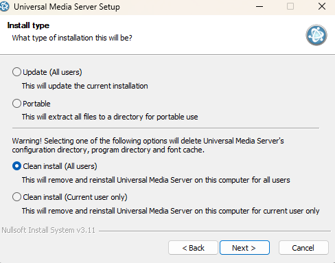

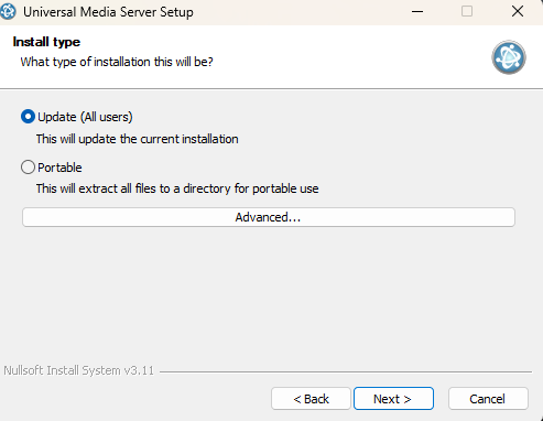

Make a backup of C:\ProgramData\UMS then do a clean install (click advanced) of UMS to reset everything. You can restore the backup in the future if you want to quickly restore the settings or your database once we have eliminated that as a problem, but you don't have to if you don't care about played status of thing you have already watched.

If that still does not improve things then try going back a few versions (doing clean install each time) to when it did work and post logs of it so I can compare.

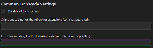

In the meantime you could get the current version to work if you force transcode of everything which will use HLS and this should be just as good as streaming and allow subs and audio tracks to be changed on the fly. I think you just need to set this box to * to force everything to transcode.

Re: In the meantime you could get the current version to work if you force transcode of everything which will use HLS and this should be just as good as streaming and allow subs and audio tracks to be changed on the fly. I think you just need to set this box to * to force everything to transcode.
Ans: When making the change to force Transcoding of everything, nothing works.

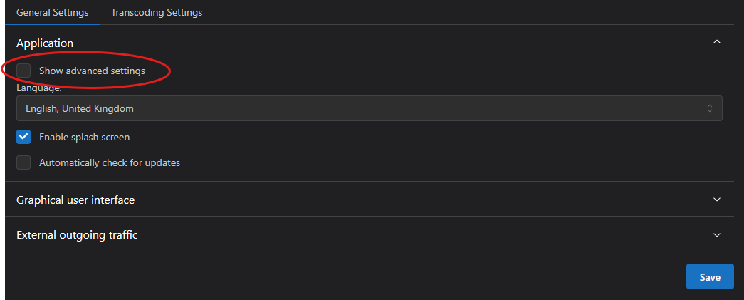

binary512 wrote: ↑Mon Jan 19, 2026 6:36 am Lastly, I noticed that when using the web interface (localhost:9001) to change settings, under Server Settings, almost everything is gone. The ONLY option that shows is "Disable Subtitles".
I cannot change or even view any of the Video Files Engines. I can only see and change them via the GUI.
There is the option to show advanced settings that will unhide them. The the option in the conf only changes the old GUI.
When installing it should have asked whether to hide advanced settings and should have applied to both GUIs, but maybe installer cannot alter the setting if it is stored in the browser.
Screenshot 2026-01-18 195713.png (21.57 KiB) Viewed 394339 times
