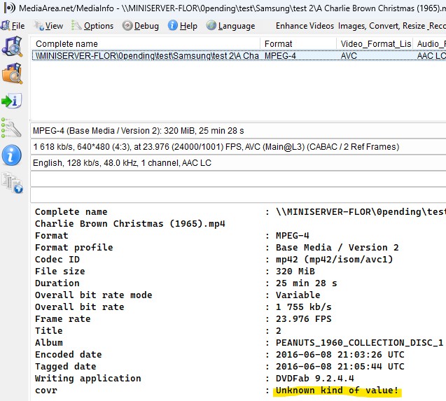

I also just noticed something "different" about this video file. According to the MediaInfo utility, the "covr" metadata shows "Unknown kind of value!".
Not sure if this could impact things...

There were some things in the media info that I was unfamiliar with and the covr field was one.
I looked up what all the fields mean and this one does not exist, but there is a cover field so maybe this was a typo when the video was encoded.
That would explain the "Unknown kind of value!" message.
The other thing was the codec ID being mp42 (mp42/isom/avc1)
This appears to mean "MPEG-4 Part 2" which would be part of the standard MP4 playback support but need to look more into this.
It might be your TV does not have support for part 2 as I see mention it is basically H.263 in a MP4 container, however one of the supported formats in the specs is H.263 Sorenson.
There is also a menu stream which I did not know was possible in MP4s. Maybe it is this that is causing it.
