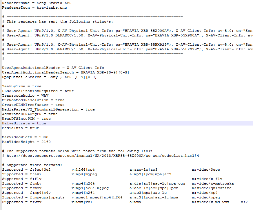

Try to add
MaxVideoWidth = 3840
MaxVideoHeight = 2160
to your renderer conf (Sony-BraviaXBR.conf)

I added that information but it's the first time I've edited one of the .conf files. I attached a file showing what the .conf file looks like after editing in notepad++:
If I edited this incorrectly, please let me know.
After making this change, I no longer get an error but when I attempt to launch a video it just displays a black screen with no audio or video. I let it sit at the black screen for approximately 10min before closing VLC. The new log only shows this:
