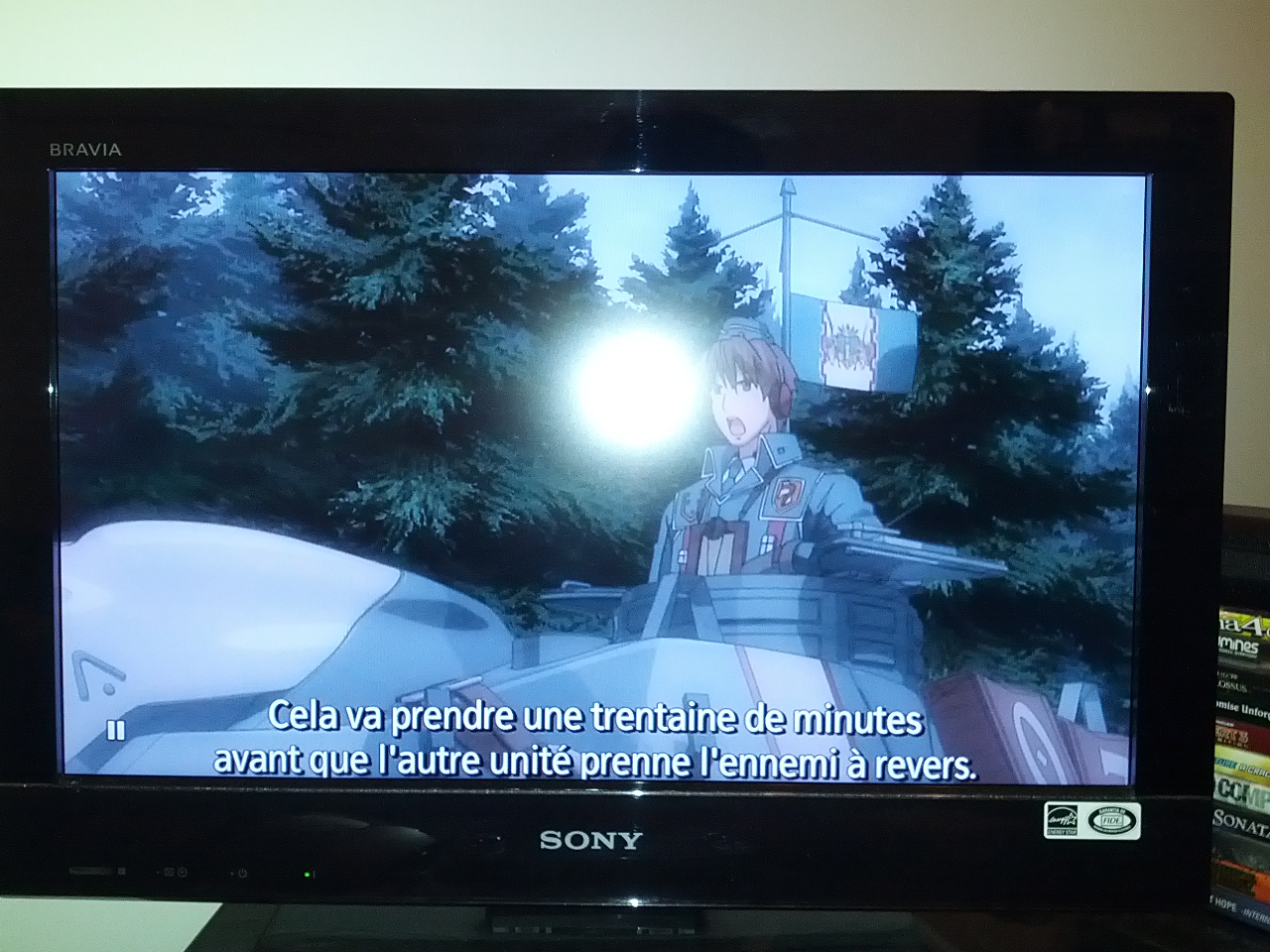

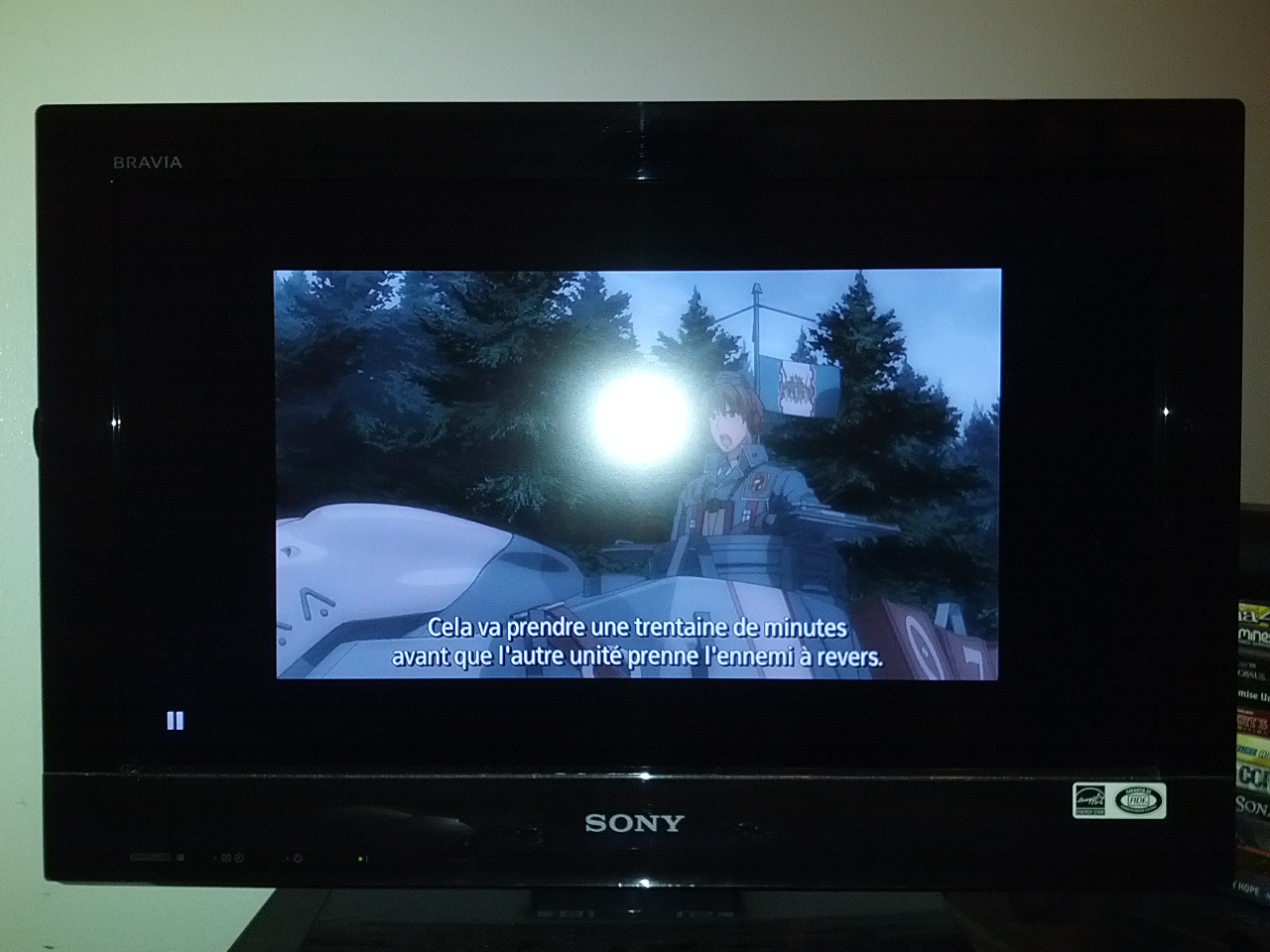

I haven't played a blu-ray disc on this tv in a while, but I don't recall it being cut off like this. It also works fine on my computer. When popping up the menu with the triangle button (I'm streaming to my PS3) while a file is being played and changing the view mode, you can notice just how much image is being lost. See the attachments. Notice the antenna on the top of the tank, the "7" on the bottom right of the image and the triangle motifs on the bottom left. Compare the two images.
Of course, it goes without saying that I am interested in watching videos in full screen. It's not a big deal as I can still read the subtitles, but depending on where they are on the screen, sometimes letters will be offscreen. It would be preferable if this didn't happen.

I see what your talking about.. and what's the resolution of the Video? Im wondering if the first resolution is set to something other than "1920" (1080p/i) or "1280" (720i/p)...
Use mediainfo: http://sourceforge.net/projects/mediainfo/

The videos are in 1280x720, but that shouldn't really matter. This happens for every video I stream, regardless of resolution. And this does not happen with games I play on this TV; I get the full picture. Which is why I believe that UMS is the culprit.
