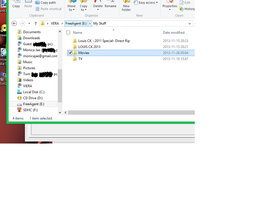

It does exist actually. I had actually had it working yesterday, but now it's not:
(89.63 KiB) Downloaded 475 times
Ok, i hope that's enough info. I wanna watch movies!!!
