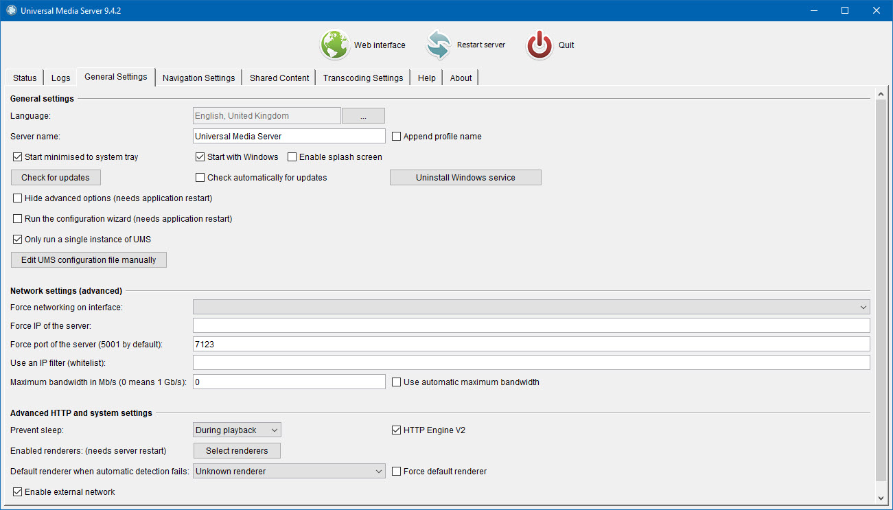

Where is this setting. It is not available in 7.4.2, so how am I supposed to have selected it?

No uninstall service option is available.

I'm sorry to say so, but your own screenshot confirms my suspicion that UMS has been installed as a service. There's a button there that says "Uninstall Windows service". It only appears if UMS is already installed as a service.
Push that button and then reboot your PC. After that, see if things haven't improved..
