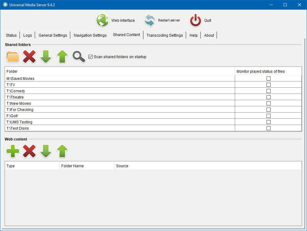

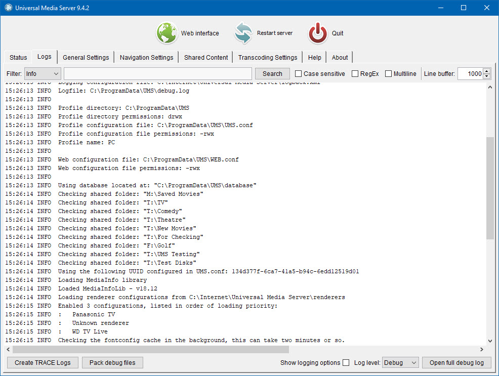

If you create shared folders then amend later (I have added the 'UMS Testing' and 'Test Disk' folders) although the amendment shows in the log, none of my devices can see the new folders.
No amount of turning PC, UMS or devices on an off again works.
The only solution I have found is to uninstall (yet again) then create the shared folder from scratch with the new amendment.
Surely someone must know that having to reinstall (not just for this but for other setting changes too) just isn't practical!
If the log displays the shared folders then the devices should be able to view them. There should be a means to reinitialise UMS with the desired changes.
As a work around, you can move the new shared folder to an existing folder that was in the original list.
Even though you can't see it as folder in its own right, you can view it as sub folder!?

I just tested and new folder additions are visible for me if I restart UMS. Please provide logs so we can see why it's not working for you

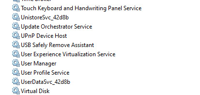

I must say that it sounds like AnnieBody is STILL running UMS as a service. That would explain all the strangeness of not updating despite restarting.

Fortunately, I found out about the UMS issue which was giving me loads of problems and reinstalled UMS again without installing it, so this is definitely not a windows service issue:

Which of my three profile do you want a debug of?
They all behave the same!
Re: Shared Folders Not Updating Bug
Any of them as long as the logs show the bug being reproduced
