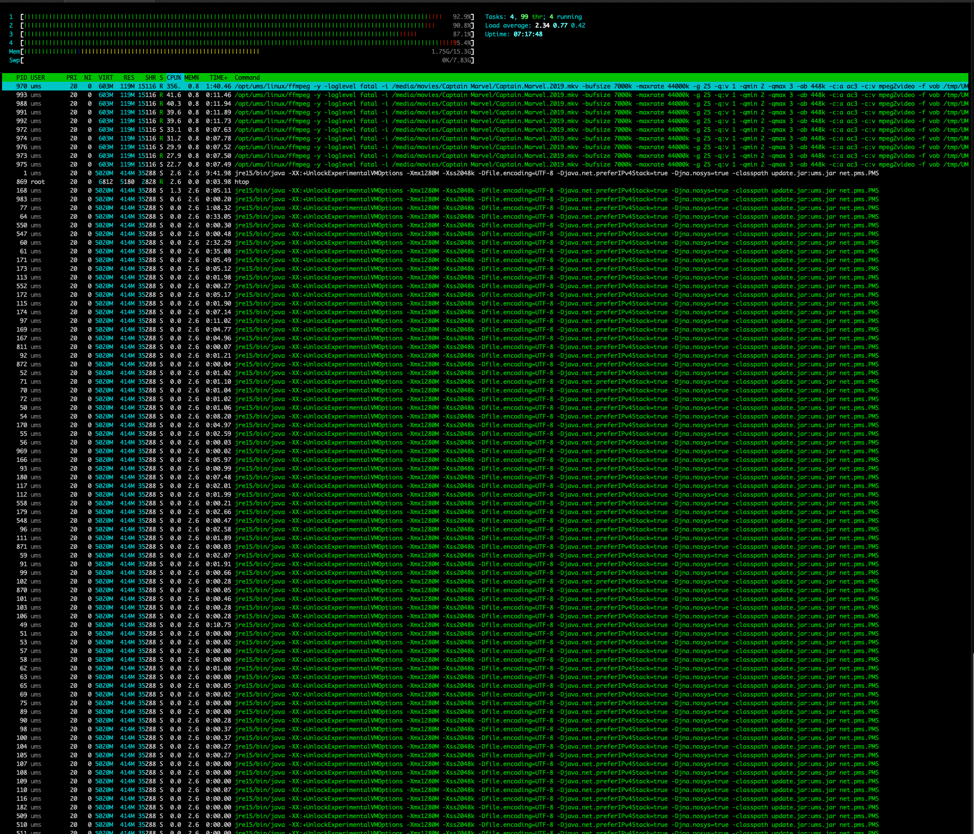

I have attached of a screenshot of my system's resources while UMS stutters for your review
Screen Shot 2021-01-24 at 7.51.40 PM.png (1.05 MiB) Viewed 6198 times
Is there anything else I can try?

That said, I'm not sure either fragmentation or memory management is the issue here. What looks very suspect to me is that you have 9 different ffmpeg processes running at the same time, not to mention all the Java processes. I'm not familiar with the view in the screenshot, but I assume that since they all have different PIDs that they actually are different processes, not just different threads. If they are threads, it's as would be expected, but I've never heard of threads being assigned different PIDs..
