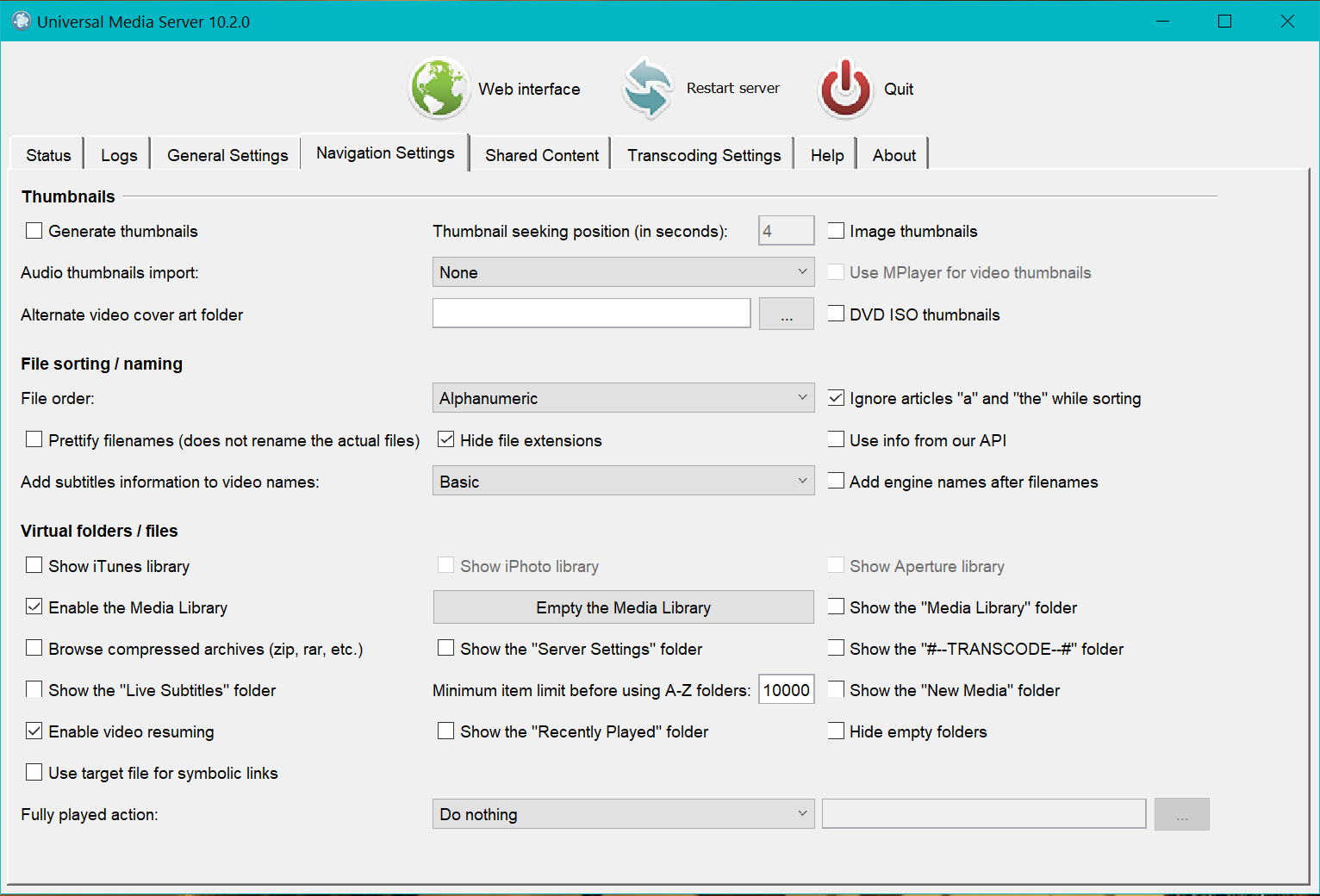

Hello, I'm still trying to clear any cache, I don't want any thumbnail preview.
I already read everything and everywhere about that without any successful fix: I still have thumbnails raised from movies from a disconnected HDD (since six months) for movies completely different
I try to reset Media Library, fully uninstall the program, remove manually any remaining folders, clean the registry, install back (clean install) without success
The curiosity is that trouble happen with MKV video and MP3 (yes, I have a video thumbnail preview for the audio files) files only, MPG thumbnails are correctly NOT shown
Off course any setting is disabled (unuseful)
