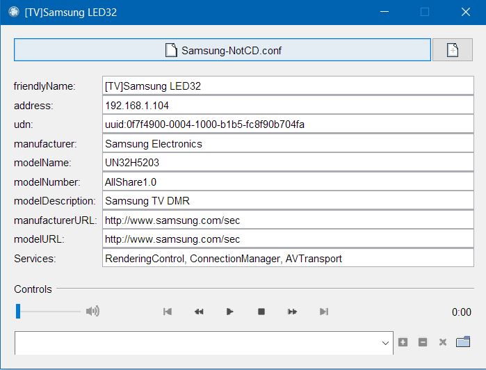

Hi, thanks for the conf file. I gave it a try, hopefully I did this correctly. What I did was click on the TV within the detected media renderers under the Status tab. This pops up a window that had shown that it appeared to be using a file called "Samsung-NotCD.conf". There was a little button next to this with a [+] sign in it which if you hovered over said "Customize this device" and when clicked it asks you where you want to save a new conf file using a new name "[TV]SamsungLED32-0f7f49.conf" which it placed in C:\ProgramData\UMS\renderers. I then appended the contents of the conf file you uploaded into this file and saved it, and then reloaded UMS. I then tried testing playback of the same video I've had trouble with and noticed no change; the same abrupt stop still occurs. Was there a different way I should have tried to implement the new custom config? Perhaps I should have made a backup of the NotCD conf file and then overwritten the contents with your conf file instead?mik_s wrote: ↑Sat Mar 27, 2021 11:43 am Give this one a try, it was originally the Samsung-H4500.conf but I altered it to match yours. Hopefully it should work better as all the existing ones for the H series are very similar.
I might see if I can do a generic one for the H series that can replace the model specific ones.
I've noticed that now at the top when I click on the TV under renderers the new conf file ([TV]SamsungLED32-0f7f49.conf) is shown but instead of a plus sign to the right to customize like before, there is now a button to the left that says "open parent configuration" which is the NotCD conf file that was up top originally. I'm not sure if it still has influence as a parent config? I assume that if I wanted to revert back to how it was before is to close UMS and delete this new conf file out of the programdata\ums\renderers folder?
What should I try next?
