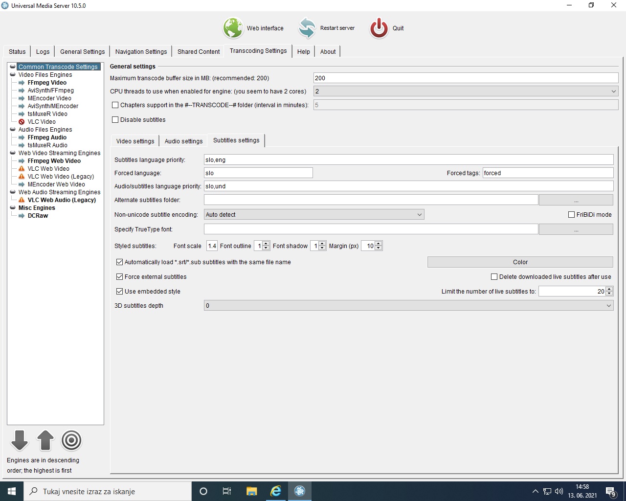

Now I have problem with subtitles, its show me all the time only english subtitles. Any ideas?
I attach picture of my settings
- UMS subtitle.jpg (236.89 KiB) Viewed 27268 times

Setting Audio/subtitles language priority = slo,und is wrong. See the description of the Audio / subtitle language priority in the https://github.com/UniversalMediaServer ... -Subtitles
So your setting should be
Determine the audio and subtitles language pairs ordered by priority to try to match.
Audio and subtitles language should be comma-separated as a pair, with each pair semicolon-separated. In addition to language codes, there is und (undefined, e.g. we couldn't detect the language), * which matches everything, and off in the subtitles field to disable subtitles for that audio language.
By default the values for English users are eng,off;*,eng;*,und, which means: If audio is English, disable subtitles, if audio is something else, display English subtitles, or undefined subtitles, in that order.
*,* will display all the possible combinations.
slo,off;*,slo;*,und,
