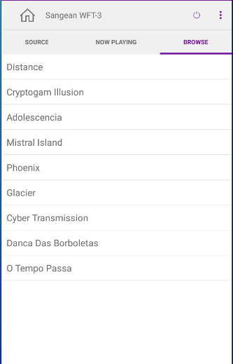

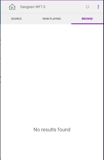

After I've started a trace log I selected a random UMS shared folder with mp3 files on the Sangean. This device responded with "No results found" (zie attached image). The log is also attached.
Then I uninstalled 11.0.0-a2 and installed 10.19.0 again. I selected the same shared mp3 folder in 10.19.0, and now the normal content of the folder was shown on the Sangean. I also attached that image.

- folder_with_11.0.0-a2.png (9.6 KiB) Viewed 71971 times
- same_folder_with_10.19.0.png (17.33 KiB) Viewed 71971 times
