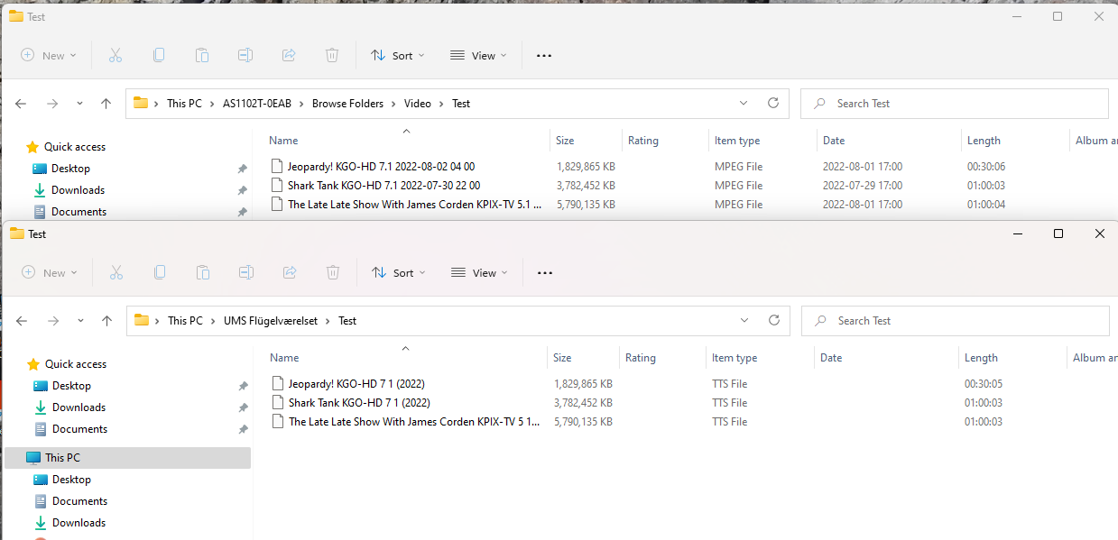

Thanks mik_s. I exited UMS and deleted the database as you suggested. After restarting UMS, the database was recreated, but unfortunately the problem persists. As a test, I set UMS and MiniDLNA to share the same folder. When browsing DLNA content on my PC, there is a date on the files served up by MiniDLNA. The exact same files (names are different as I have the "prettify" option turned on) served up by UMS 11.3 have no dates (see attached screen shot). Any help is much appreciated.

The database errors are gone now but is still sending CREATIONDATE=0 to the renderer. I checked my logs and it does the same.
I think this has been overlooked in the update from V10 to V11 as the service that deals with these network requests was changed and a lot of other network related stuff was improved.
I'll make an issue on GitHub so the devs can look into what is causing it.
