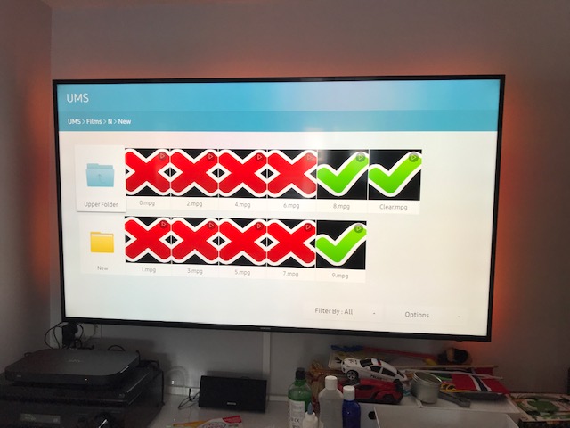

I take some of that back.
I put the UMS.code file in ~/.config/UMS (rather than where the app is installed) and I got a bit further.
When I browse the folder that I'm trying to protect I see the following, but no way to actually enter the pincode.

Sorry I missed this. I posted a reply on GitHub and I think this feature is buggy at the moment as I could not get it to work properly on my PS4.
To enter the pincode you have to play numbered files, then once it has been accepted then your "New" folder (it will be called the same as it's parent folder) inside that folder will show your content.
I could only get it working by setting the code to "1" or "12" but nearly everything else failed. If it is not working for you then try the same thing.
Just remember to press the reset "server button" every time you edit the UMS.code file.

Thanks, I'm having *some* success with a single digit code, although when selecting the number file to watch, the tv complains about the audio track, then skips to the next file automatically, with an error alert on screen, with Skip and Stop, and you have to be pretty fast to select and hit Stop to get back to the list of files, and then watch the video.
This feature still definitely needs some work to make it more resilient, and better docs.
