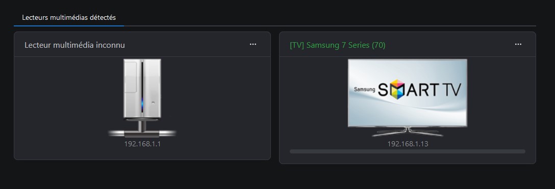

In fact, when I launch UMS, my SmartTV appears on the main UMS screen but my BD player does not. The "unknown media player" that appears next to my TV is my Internet Box (known IP).
But my BD drive is invisible to UMS. Strange, right? Especially since I haven't changed anything in my Firewall. The IP adress of my BD is finishing by .20 (I know it) but nothing at screen. If I launch VLC on my Smartphone, it is detected but not my BD
