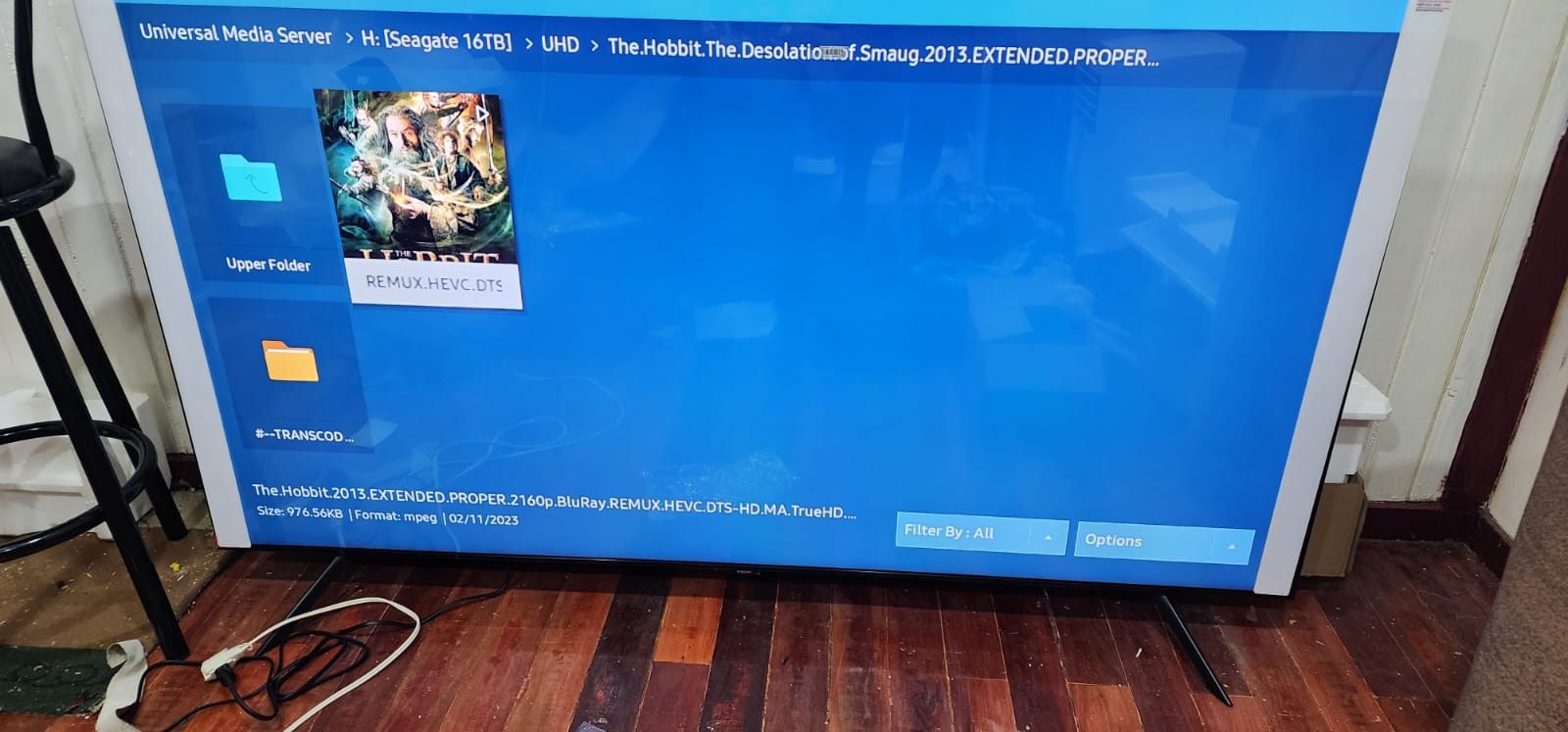

I have the same tv (UN75CU7000P) and im having problems with playing my UHD and 4K MKV files...they show up as wrong file size and type when viewing on the tv, also at that point i'd like to say the very same file play through UMS same settings and all on another tv. is there something i have to set to accomodate the other TV?

The file size and type will be wrong if the video is being transcoded, and you will probably be unable to seek too.
UMS should only be transcoding videos that are not supported on your device and stream what is. If this is not working right then either UMS is not correctly matching it to the right conf file or there is not one available for that device yet.
The logs that you posted do not show your TV and nothing was playing so could not see if it was transcoding or not and the reasons why.
The zip file does contain your previous logs and does show that most videos are being transcoded, but as this was before putting in trace mode it does not show the decision making. And as your TV did not show in the trace logs then the conf UMS was using did not get attached either.
Could you redo your logs and make sure you play something on the TV before packing them? That should have enough information to get a working conf for you.

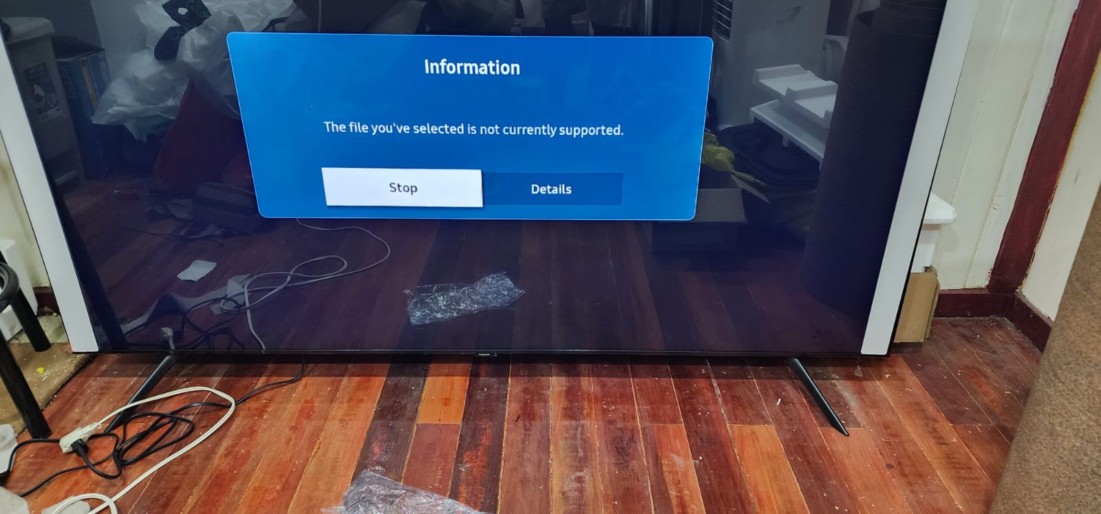

The movie isnt playing at all i dont know if this one will have enough info.....this movie shows up as the right size and plays with the seek without issues on my samsung Q60A 65 inch but not on the CU 7000

I can see that there is no conf file for that model TV so UMS is falling back to an old one to gave some support. As this lists only basic formats all your 4K videos are being transcoded.
The newest conf for Samsung TVs is Samsung-UHD-2019.conf so I modified that to work for yours.
I don't know the specs of your TV as could not find that information but I would guess it is very similar to that one, but it may not be perfect.
Just copy this file to "C:\Program Files (x86)\Universal Media Server\renderers" and you might have to restart UMS for it to be picked up.

Thank you very much..it is working..all the 4k /UHD files are playable and the show up as the correct file size. if anyone needs help with the CU7000 i can assist...i had to do some simple mod of the files before i got it to work.

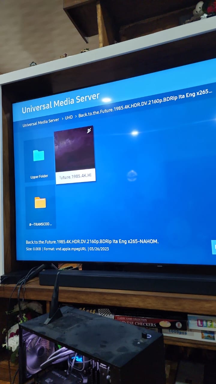

I may need more help...after upgrading to the newest version im in shambles again...please help me

This might just be because that file is in a format that is unsupported. The filename mentions DV which is not mentioned in the conf as a supported format.
To check try playing from the #--TRANSCODE--# folder and choose "No transcoding"
If it still does not play then it is not supported by your TV so will need transcoding.
Is there any attempt to play or does it just say it can't play?

So I'm still having issues as well. UMS is being detected but like the other person who posted here, I'm unable to actually play most files. They will either throw unknown errors, or occassionally will start playing but be extremely glitchy. I'm having this problem on all file types, including mkv and mpeg. However, MKVs are showing as mpegs so I think that means there is a problem (as I read in another thread).
I attempted to use the render conf posted above but doing so results in the TV not playing files at all, or even attempting to. Files are shown as 0 bytes and the log is showing as attached in the text file.
I'd appreciate any help one might give. I loaded up an alternative DLNA program (Jellyfin) and it is able to transcode to the TV just fine, but it doesn't have as much control over transcoding settings as UMS does, so I'd really prefer to stick with UMS.
