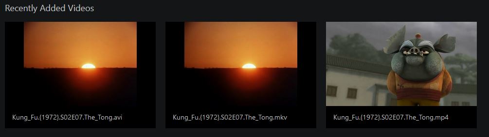

UMS has not been able to show me the series and episode metadata for Kung Fu (1972), even though they seem to be available at both IMDB and TVDB: UMS conflates episodes from Kung Fu (1972) and Kung Fu (2021) [which I don't have]. Maybe the lack of "1972" in the TVDB's name for that series is confusing UMS; I don't know. How might I name my Kung Fu (1972) files to help UMS?
Strangely, UMS produced a Kung Fu Panda (?) -themed icon for "Kung_Fu.(1972).S02E07.The_Tong.mp4". If I convert this particular mp4 to an mkv file or an avi file:
     ffmpeg -i Kung_Fu.(1972).S02E07.The_Tong.mp4 -c copy Kung_Fu.(1972).S02E07.The_Tong.mkv
     ffmpeg -i Kung_Fu.(1972).S02E07.The_Tong.mp4 -c copy Kung_Fu.(1972).S02E07.The_Tong.avi
the errant icon is replaced with a default/standard icon (based on a few seconds from the beginning of the video).
Based on the above, does UMS treat mp4 files differently than other formats?

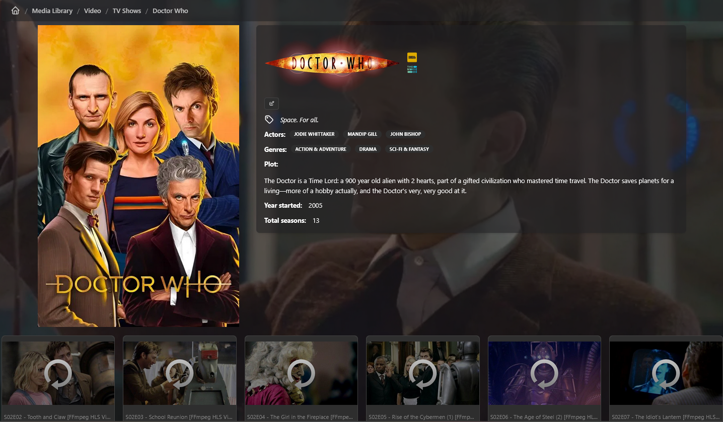

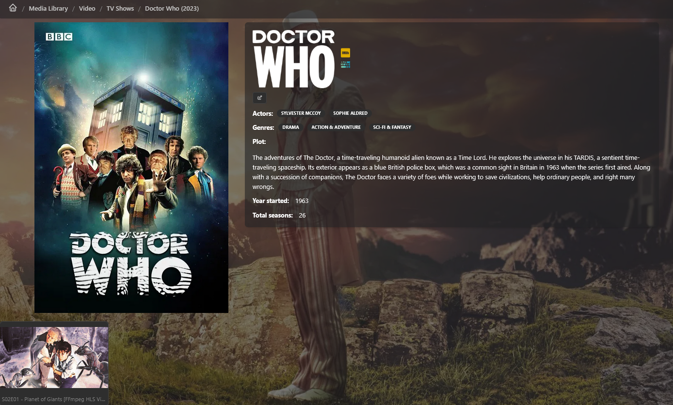

I have episodes of the latest series of Doctor Who (2023) show as the original 60's series and some as the 2005 reboot.
Part of the problem is how the 2023 series is considered a new show and not a continuation of the 2005 series.

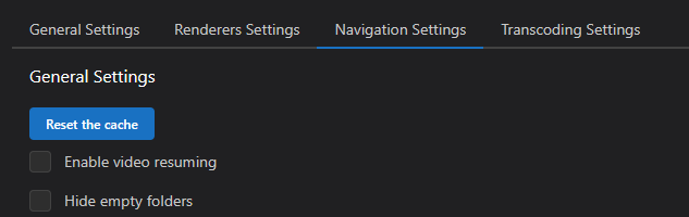

Resetting the cache should force UMS to rescan everything and get new metadata.
However you should upgrade to the latest version first as there was a bug where clearing the cache mixed up all data including filenames, thumbnails, series name etc as reported here and I don't know which version this first happened in.
